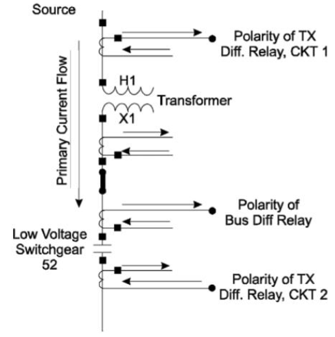

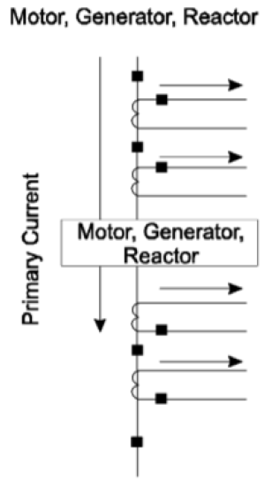

Which CT/CTs is/are connected in circuit with correct Polarity?
A.
B.
C.
D.
E. A and B are correct
F. A, B and C are correct
G. A, B, C and D are correct
Answer: F
