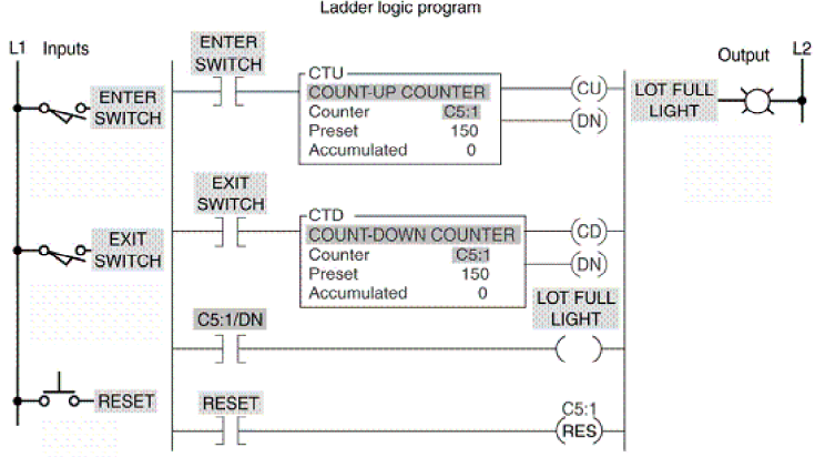

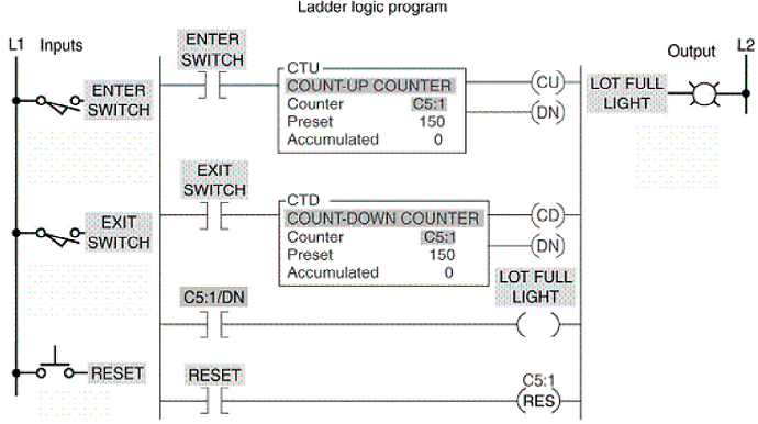

Which instruction, when true, will preset the counter to a count of zero?
A. Enter switch input.
B. Exit switch input.
C. Reset input.
D. Lot Full Light output.
Answer: C
