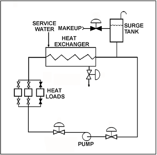

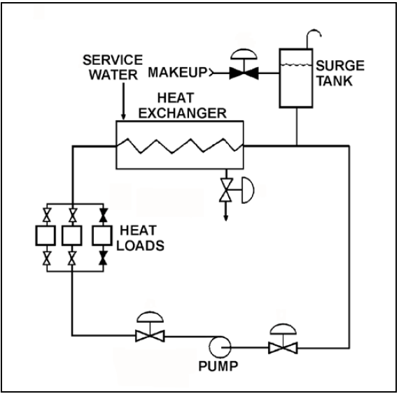

Which one of the following will enable the pump to achieve a higher volumetric flow rate before cavitation occurs ___
Refer to the drawing of an operating cooling water system (see figure below).
The pump is unable to achieve its rated volumetric flow rate due to cavitation.
Which one of the following will enable the pump to achieve a higher volumetric flow rate before cavitation occurs?
A. Decrease the service water flow rate.
B. Operate the system at a lower pressure.
C. Move the surge tank connection closer to the suction of the pump.
D. Remove the existing pump motor and install a motor with a higher horsepower rating.
Answer: C
