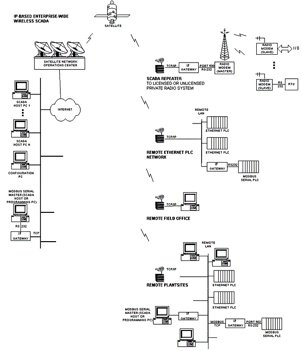

Wireless SCADA systems can range from simple Point-Multipoint systems like the 900-MB Spread Spectrum system below using Modbus protocol:

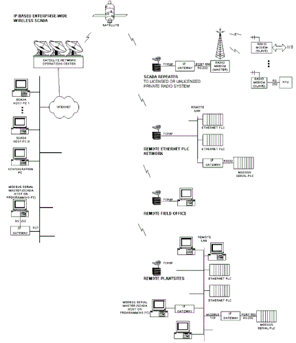

….to IP-based enterprise-wide systems which use IP protocol to integrate a variety of autonomous communications subsystems:
