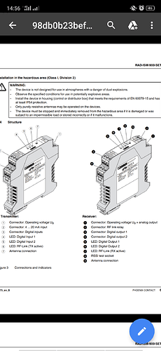

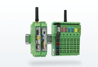

Wireless I/O from Phoenix Contact is the ideal solution for the wireless transfer of digital or analog I/O signals. The right choice for your I/O communication in process and control technology.
Your advantages
  • Reduced installation and maintenance costs by eliminating cables
  • Mobility for mobile or interchangeable automation components, thanks to wireless I/O communication
  • No operating costs for transmission media, thanks to wear-free wireless technology
  • Quick and easy startup, thanks to user-friendly installation

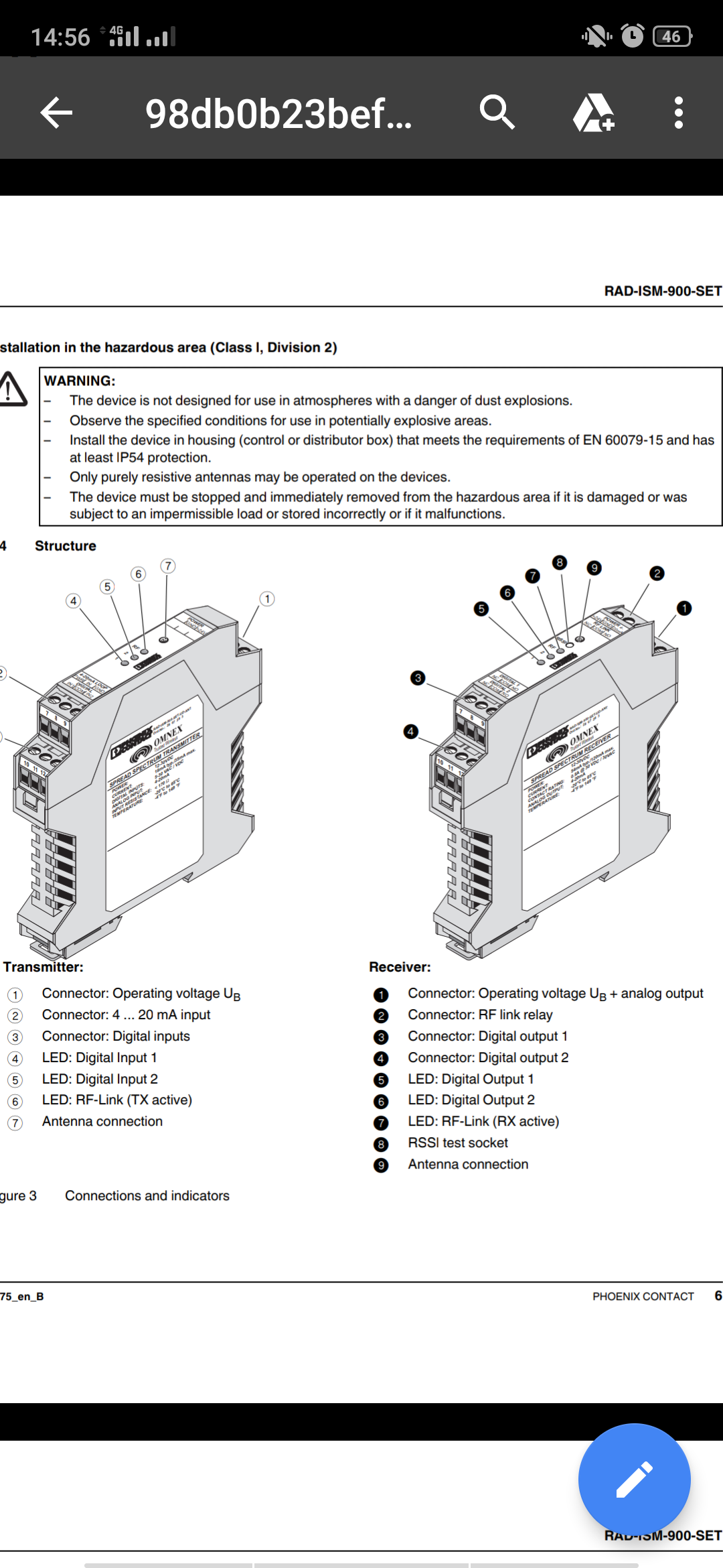

I have referred its data sheet as per it "
The device is not designed for use in atmospheres with a danger of dust explosions"
Plz suggest an explotion proof device.
I think its not an issue at all. We all use high voltage devices or control panels in oil and gas industries (field) with proper enclosure protection or/and with Purge & Pressurization techniques.
You can do the same to avoid these issues.
You can install any equipment with proper protection standards.

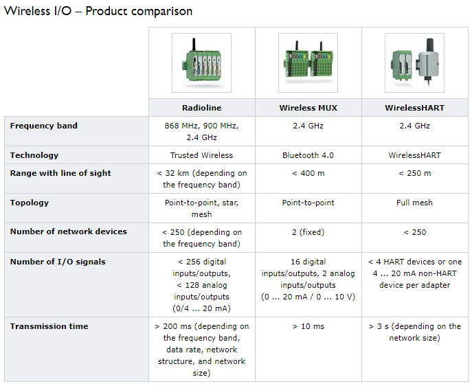

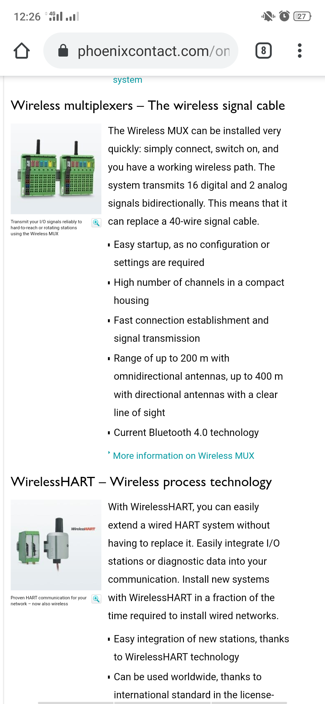

I have another problem it has got omnidirectional range up to 200m only.
My range is 3km, also truck movements & industrial electromagnetic inferences might detotriate signals.
Hi,

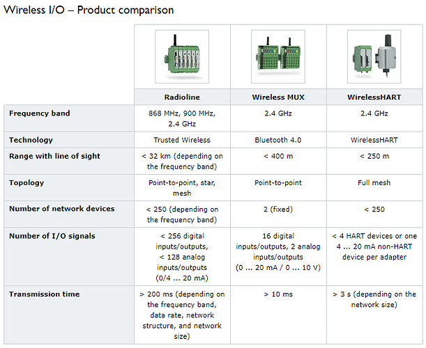

Also check Radioline model - its the powerful one.
Contact local vendor, they have many models available within their products range. They will help you to finalize the model as per your requirement.
