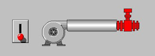

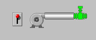

Wonderware InTouch - Once you create a graphic object or symbol you can “bring it to life” by animating it. By attaching animation links, you can make the object or symbol change in appearance to reflect changes in the value of a tagname or an expression.
For example , you can create a pump symbol that is red when it is off and green when it is on

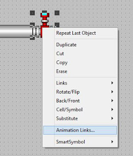

On the Special menu, click Animation Links or, double-click on the
object. The dialog box containing all animation links appears.
You can also right-click the object and then, click Animation Links.

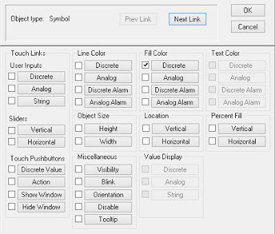

- Click the button for the link that you want to attach to the selected object.
Tip If a link is not applicable for the selected object, its button will not be active.
Tip Clicking the check box only selects the link. Clicking the link name button selects the link and opens its detail definition dialog box. The check box will automatically be selected when you click the link name button and accept the input. However, if you clear a link’s check box, the animation link is removed from the selected object.
Enter the details for the link definition and then, click OK. The Link Selection dialog box reappears and if desired, you can create another link for the object.
Click OK to accept all links for the object and close the dialog box.
