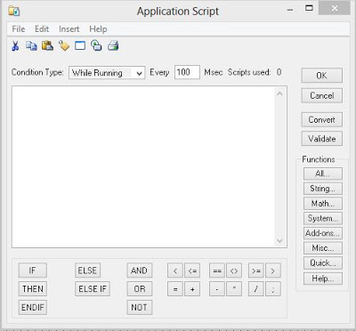

Application Script
The Application Scripts are linked to the entire application. You can use application scripts to start other applications, create process simulations, calculate variables, and so on. There are three types of Application Scripts that you can apply to an application
On Start up : Executes one time when the application is initially started up.
While Running :
On Running : Executes continuously at the specified frequency while the application is running.
On Shutdown : Executes one time when the application is exited.

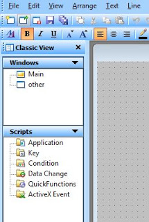

Double click on Application in Script menue
You can change condition type from while running to On Startup or On Shutsown as per your requirement

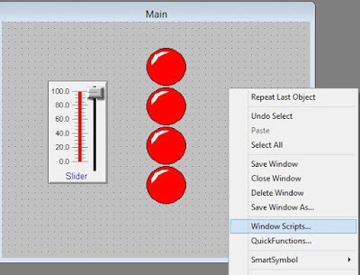

You can also right-click a blank area of an open window, and then click Window Scripts. If a script exists for the selected window, it will be displayed.

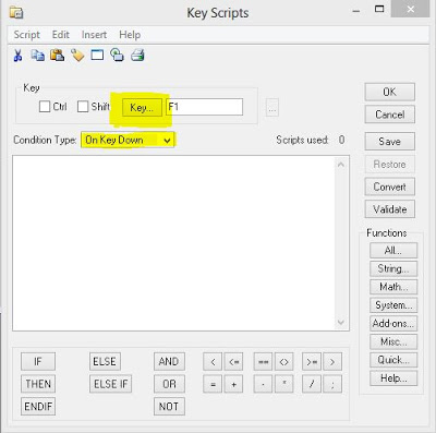

Key Scripts
Key Scripts are linked to a specific key or key combination on the keyboard. You can use them to create global keys for the application.
For example, returning to a main menu window, logging off the operator, and so on. There are three types of Key Scripts that you can apply to a key:
On Key Down : Executes one time when the key is initially pushed down.
While Down : Executes continuously at the specified frequency while the key is held down.
On Key Up : Executes one time when the key is released.
Application Explorer under Scripts, double-click Key. The Key Script editor
appears.
By clicking on key select action key from keyboard

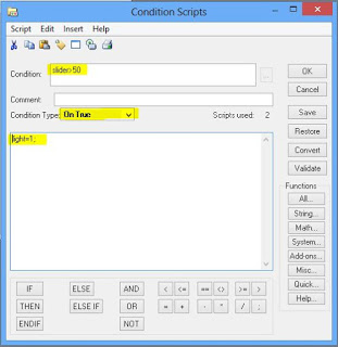

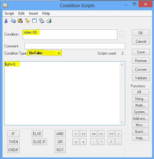

Condition Scripts
Condition Scripts are linked to a discrete tagname or expression that equates to true or false. You can also use discrete expressions that contain analog tagnames. There are four types of scripts that you can
apply to a condition
On True : Executes one time when the condition transitions to true.
On False : Executes one time when the condition transitions to false.
While True : Executes continuously while the condition is true.
While False : Executes continuously while the condition is false.

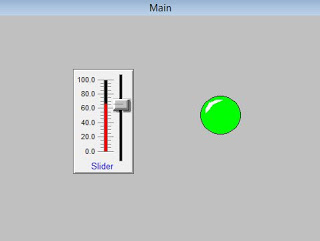

To Check create Following window by Shown objects and assigned tags
Slider --> slider
light --> light

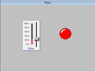

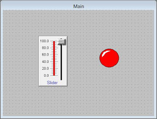

In On True Condition type condition is “slider>50”
that means when slider value is higher than 50 light will be turned on
In On False Condition type condition is “slider>50”
that means when slider value is not higher than 50 means condition is False light will be turned Off
Result Preview
