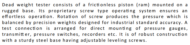

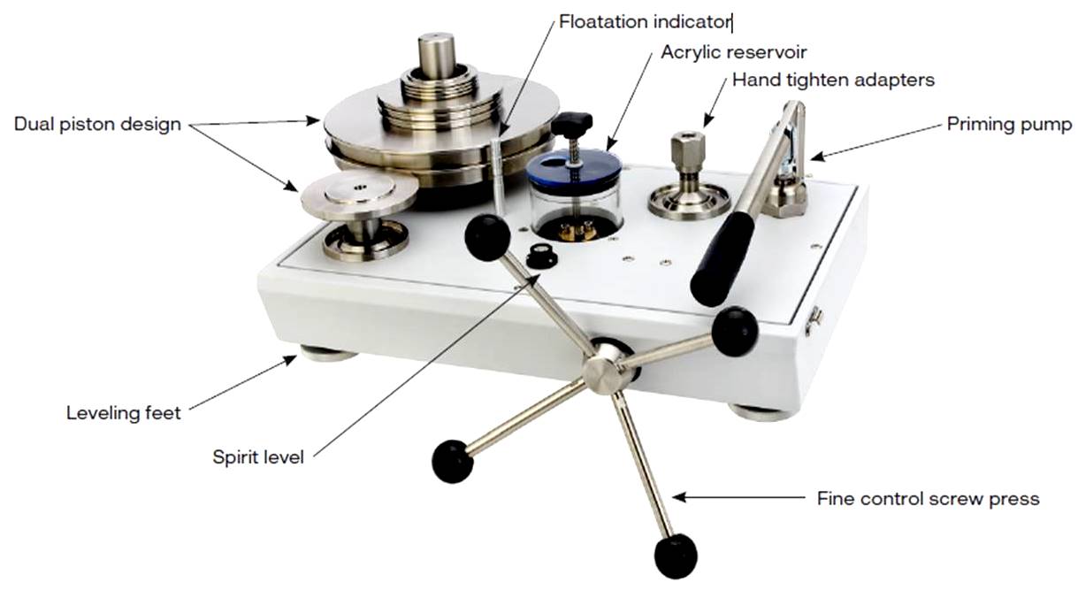

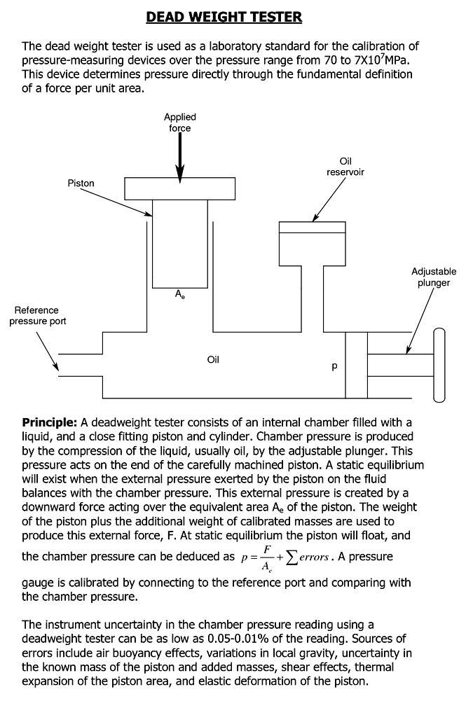

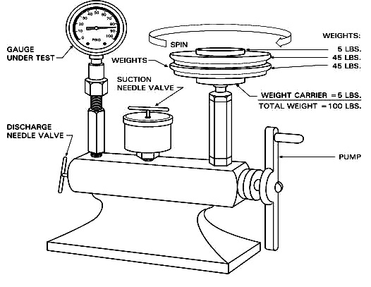

A dead weight tester apparatus uses known traceable weights to apply pressure to a fluid for checking the accuracy of readings from a pressure gauge.
A dead weight tester (DWT) is a calibration standard method that uses a piston cylinder on which a load is placed to make an equilibrium with an applied pressure underneath the piston.

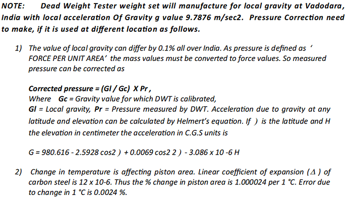

Deadweight testers are so called primary standards which means that the pressure measured by a deadweight tester is defined through other quantities: length, mass and time.
Typically deadweight testers are used in calibration laboratories to calibrate pressure transfer standards like electronic pressure measuring devices.
