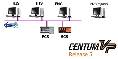

This guide walks you through installing Yokogawa Centum VP R5 on a new engineering (ENG) PC—creating a legally licensed backup of your factory’s primary ENG station.
Centum VP R5 system – with ENG spare

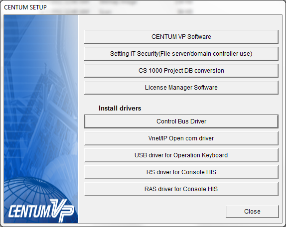

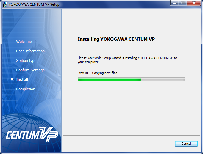

Step 3. Install Drivers & Core Software
  1. Insert the Centum VP Software CD and let Windows autoplay.
  2. First, install the Control Bus Driver (for the V-net card).
  3. Next, install the USB Driver for Operation Keyboard.
  4. Finally, install the CENTUM VP Software package.
Driver installation screens

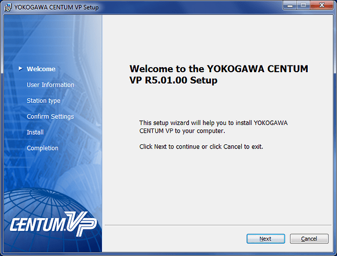

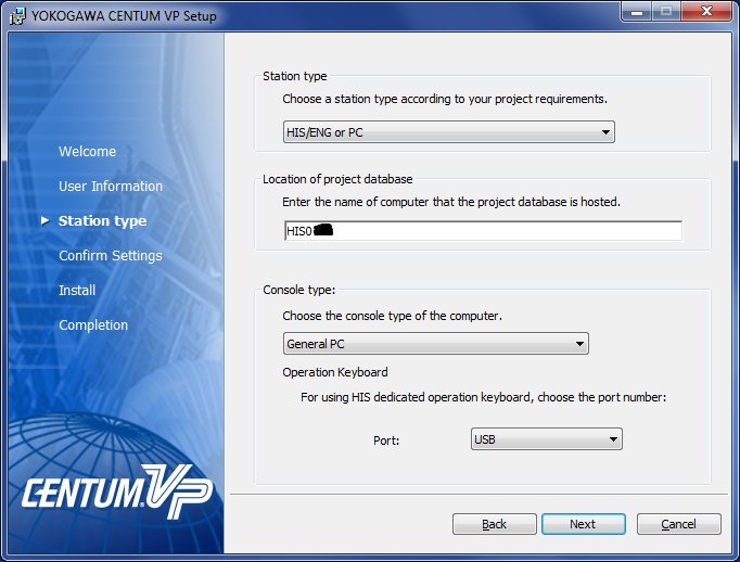

Step 4. Install & Configure Centum VP

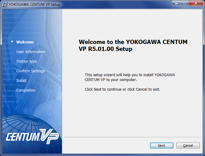

  1. Run the Centum VP installer from the CD.

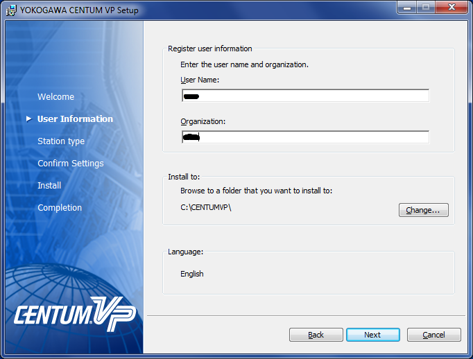

  2. Organization Name: Enter your company or unit name.

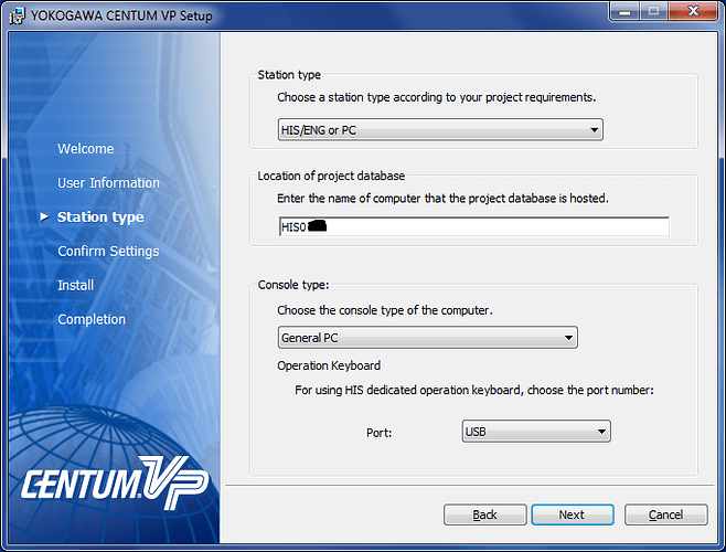

  3. Computer Name: Confirm it matches the primary ENG PC exactly.

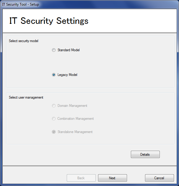

  4. IT Security: Select Yes to enable built-in security features.
  5. Model Selection: Choose Legacy Model (or match your existing configuration).

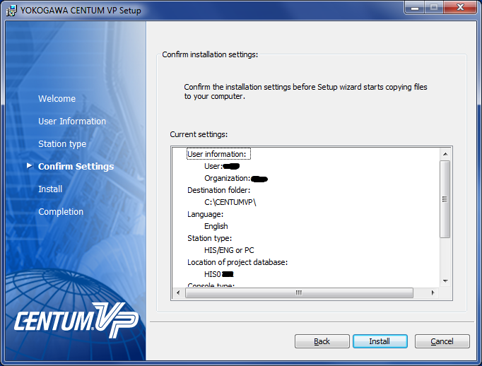

  6. Complete the installation wizard.

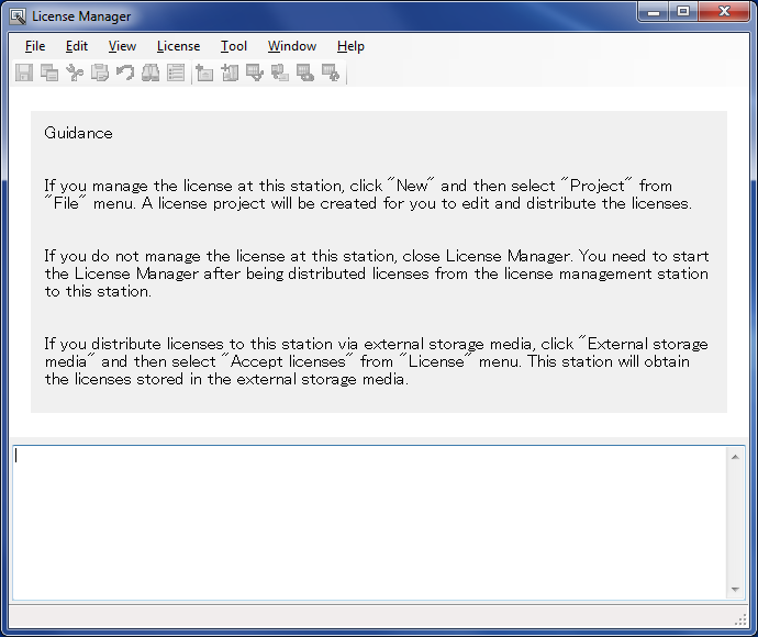

Step 5. Back Up Your License
On the existing ENG PC, launch the License Manager and export (backup) your license file to a safe folder.

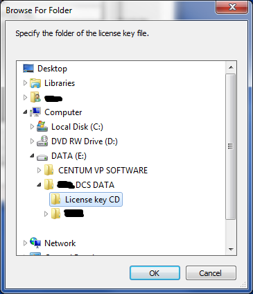

Step 6. Restore & Activate License on New PC
  1. Copy both the backup license file and the license key files (from the factory CD) onto the new PC.

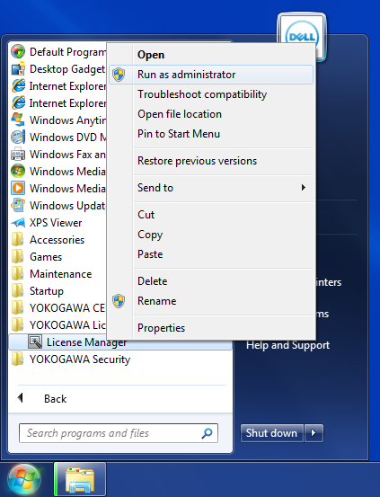

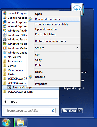

  2. Open License Manager as Administrator.
  3. Select Restore, browse to your backup license folder, and restore.
  4. Click Verify License Key, select your factory key file, then click Restore again.

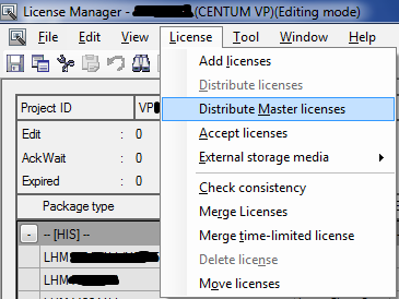

  5. Choose Distribute Master Licenses, tick only your ENG PC name, and confirm.
  6. Save the license—Centum VP will display all modules (including System View).

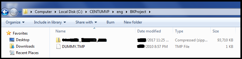

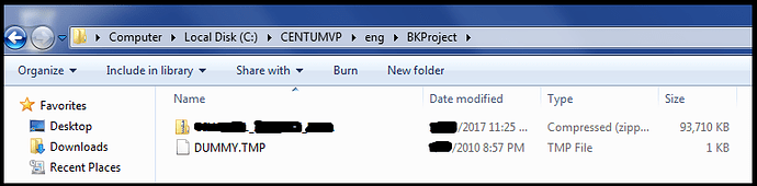

Step 7. Back Up Your Project
On the existing ENG PC, export your project (using the Project Backup Utility) and copy the resulting folder to the new PC, preserving its directory path.
Step 8. Restore Your Project
  1. On the new PC, extract the project folder into the exact same path as your ENG PC.
  2. Launch the Project’s Attribution UtilityRegister → point to the extracted folder → choose Current ProjectExit.
  3. Open System View and verify your project appears correctly.
