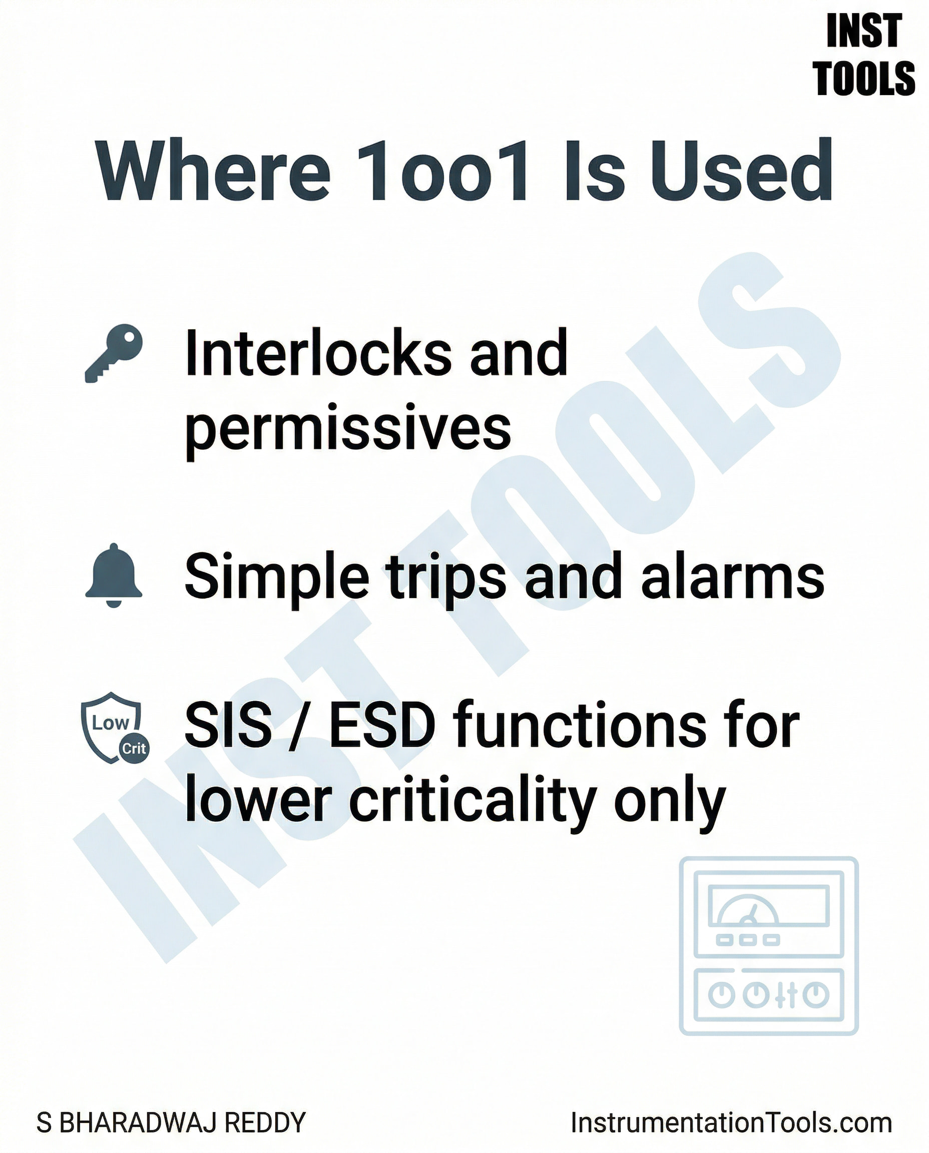

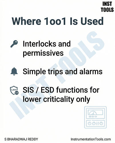

:round_pushpin: Where you see 1oo1:
:small_blue_diamond: Basic permissives and interlocks
:gear: Simple trips on PLC/DCS
:yellow_circle: Low-risk shutdowns
:shield: Sometimes in SIS/ESD for non-critical or low SIL demands

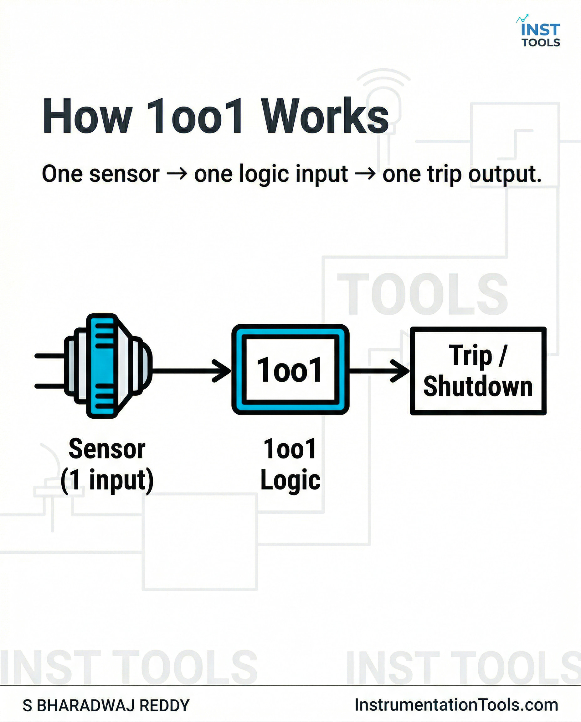

:high_voltage: Behavior with a single sensor:
:white_check_mark: Sensor healthy + process safe β†’ no trip
:police_car_light: Sensor detects trip condition β†’ shutdown
:warning: Sensor fails dangerous β†’ demand may be missed
:stop_sign: Sensor fails safe β†’ spurious trip

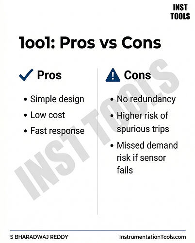

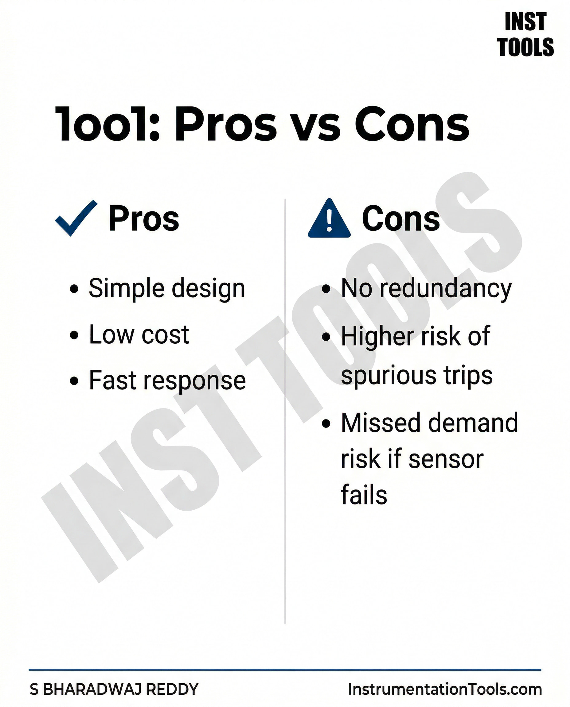

:+1: Pros:
:check_mark: Simple logic, easy to design and understand
:money_bag: Low cost (one sensor, one logic path)
:high_voltage: Fast to implement and maintain
:-1: Cons:
:cross_mark: No fault tolerance (one bad sensor = risk)
:warning: More vulnerable to spurious trips
:shield: Limited use in higher SIL/SIS applications

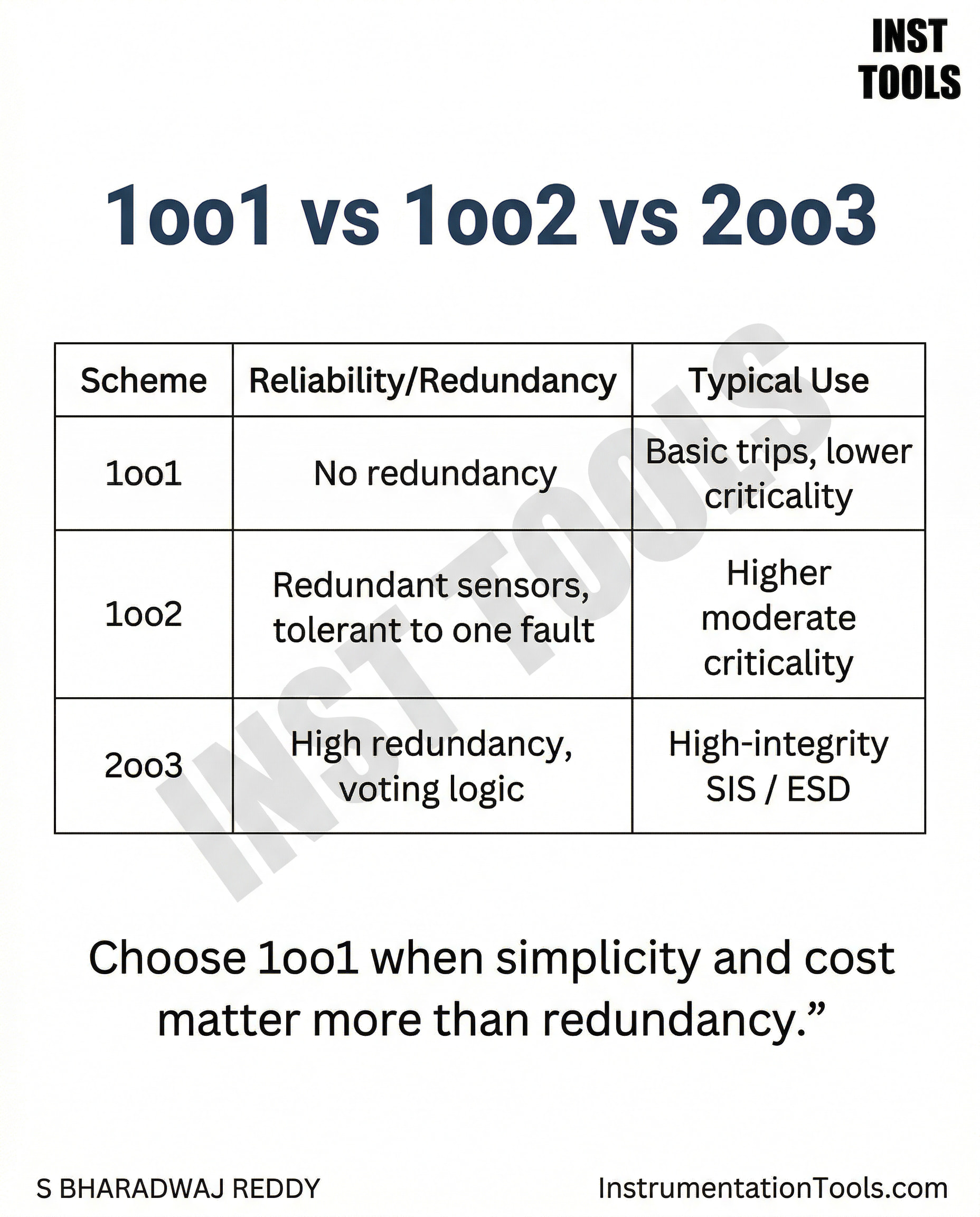

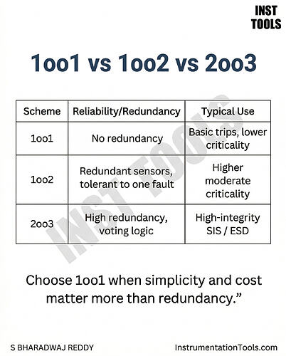

:bar_chart: Quick comparison:
:small_blue_diamond: 1oo1: simple, no redundancy, lowest cost
:small_blue_diamond: 1oo2: higher availability, but can trip on 1 bad sensor
:small_blue_diamond: 2oo3: better fault tolerance, but more complex and expensive
:bullseye: When to choose 1oo1?
Use it when the consequence is limited, access for testing is good, and simplicity is more valuable than high availability.
