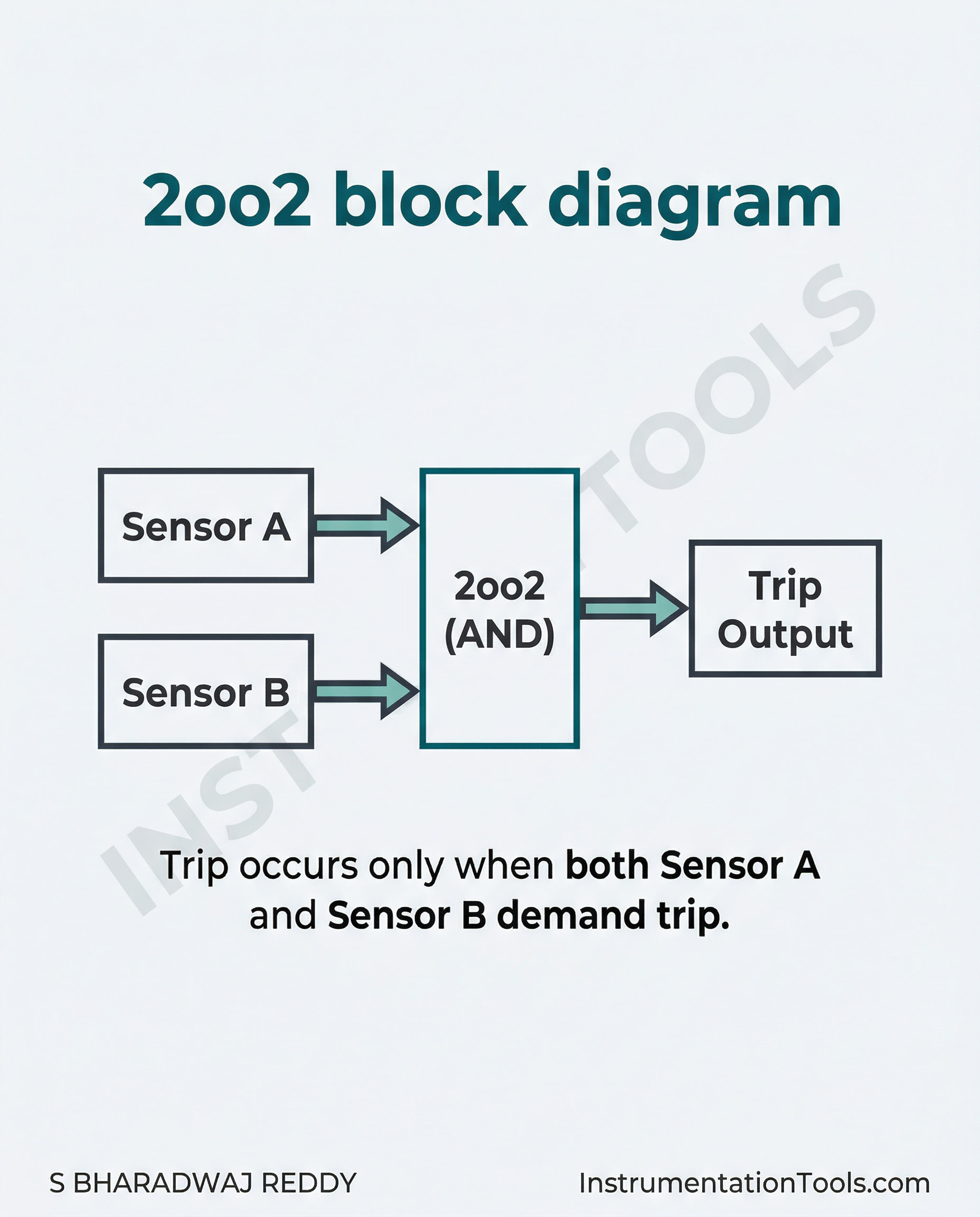

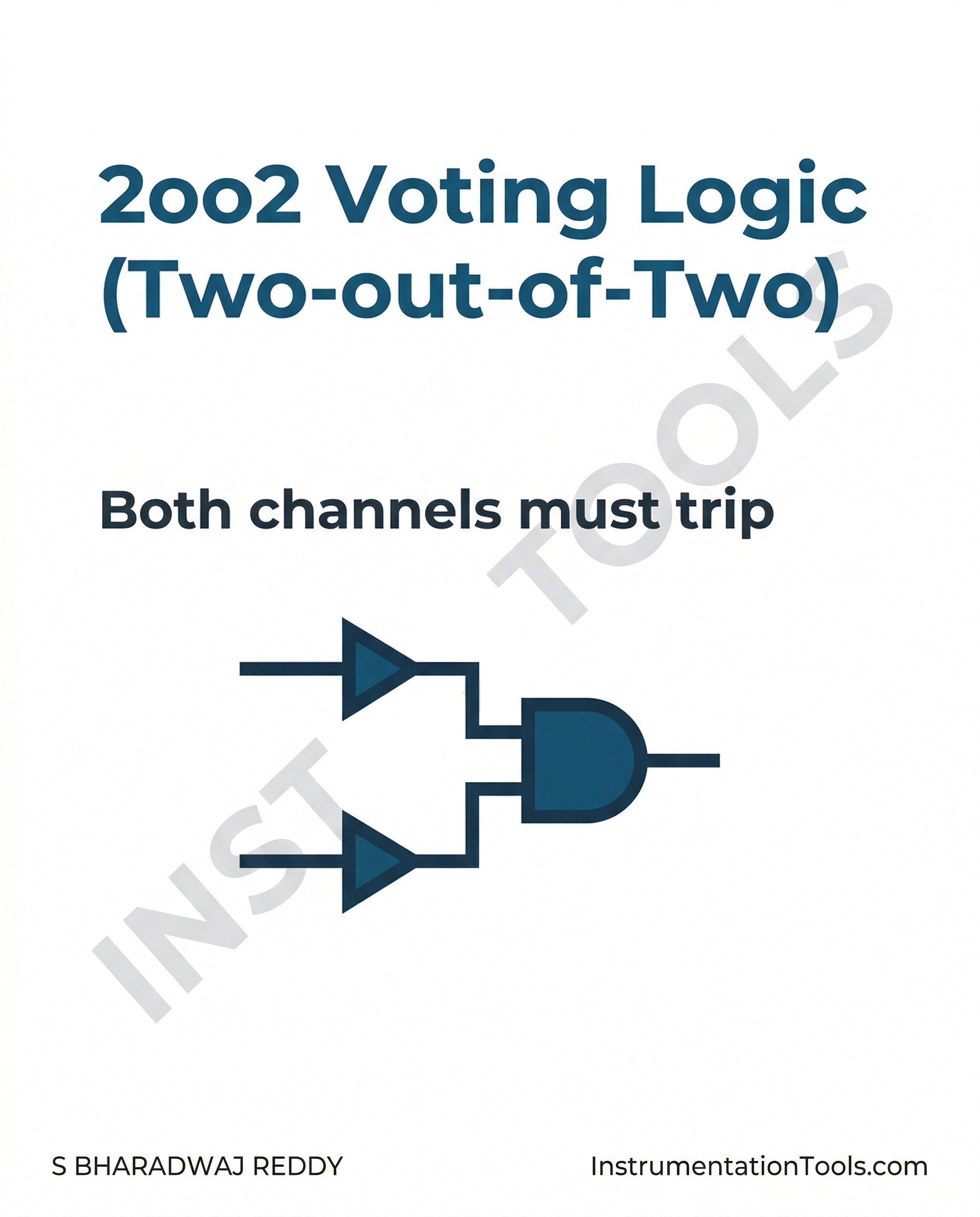

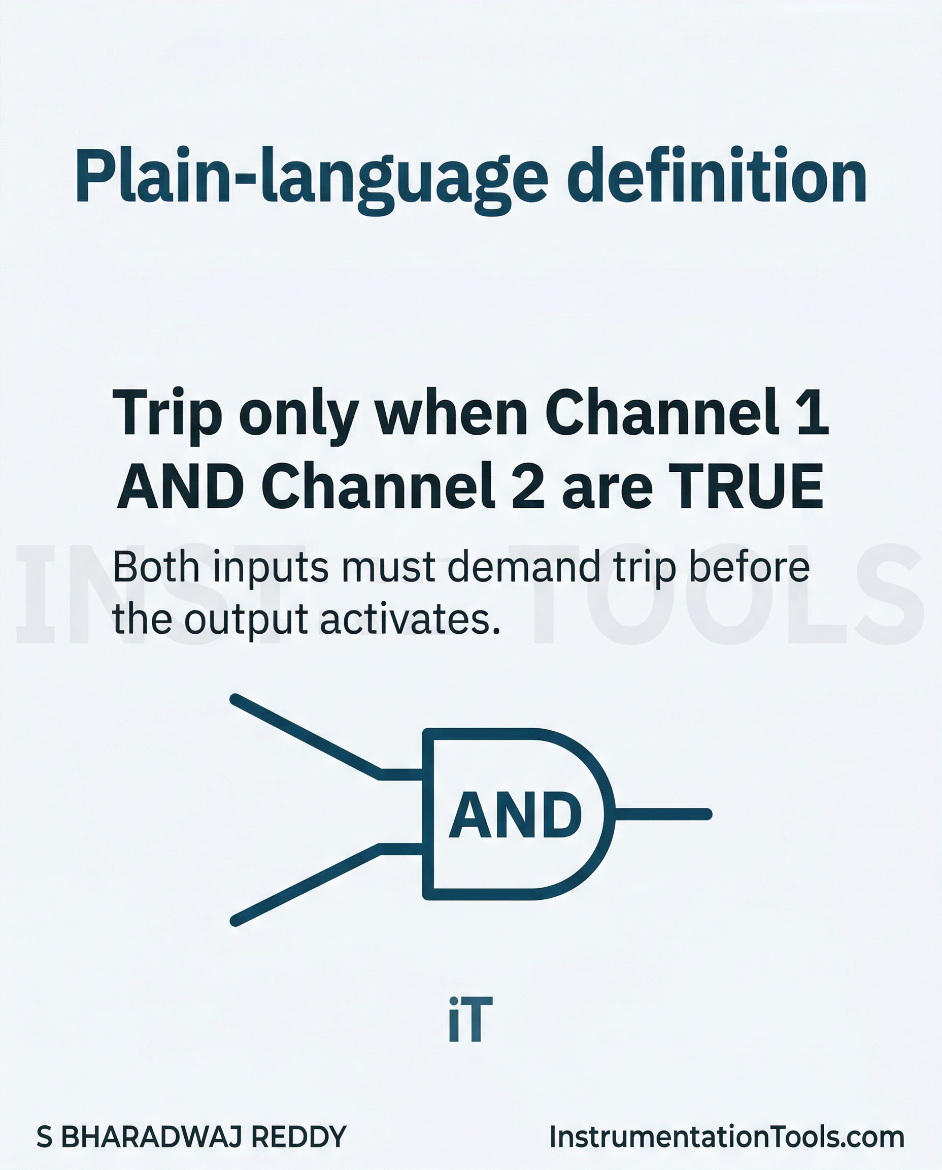

That’s where 2oo2 (Two out of Two) voting logic plays a key role.

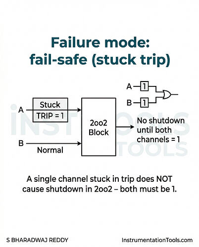

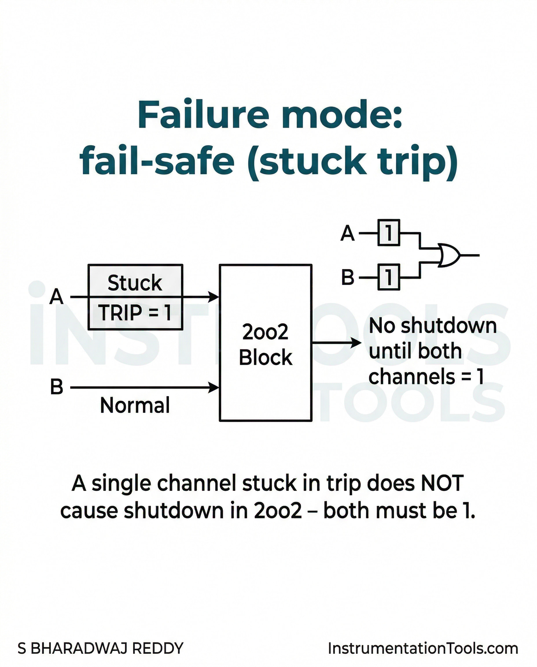

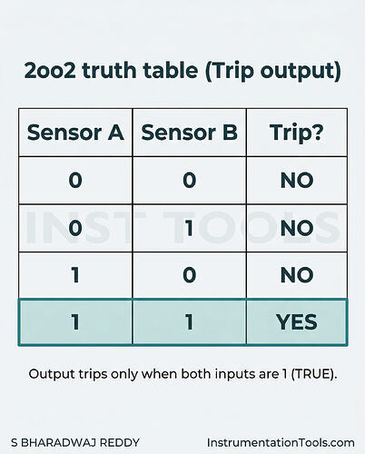

:backhand_index_pointing_right: Both inputs MUST agree to take action
:small_blue_diamond: How it works:
:check_mark: 2 independent sensors / transmitters
:check_mark: BOTH signals must be healthy & TRUE
:check_mark: If one fails / disagrees β†’ NO output action
:brain: Logic:
:right_arrow: Output = A AND B

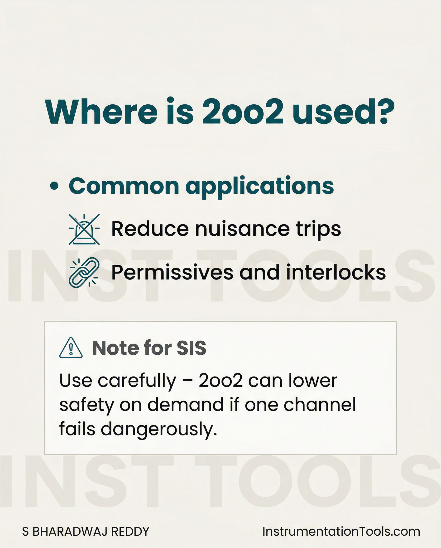

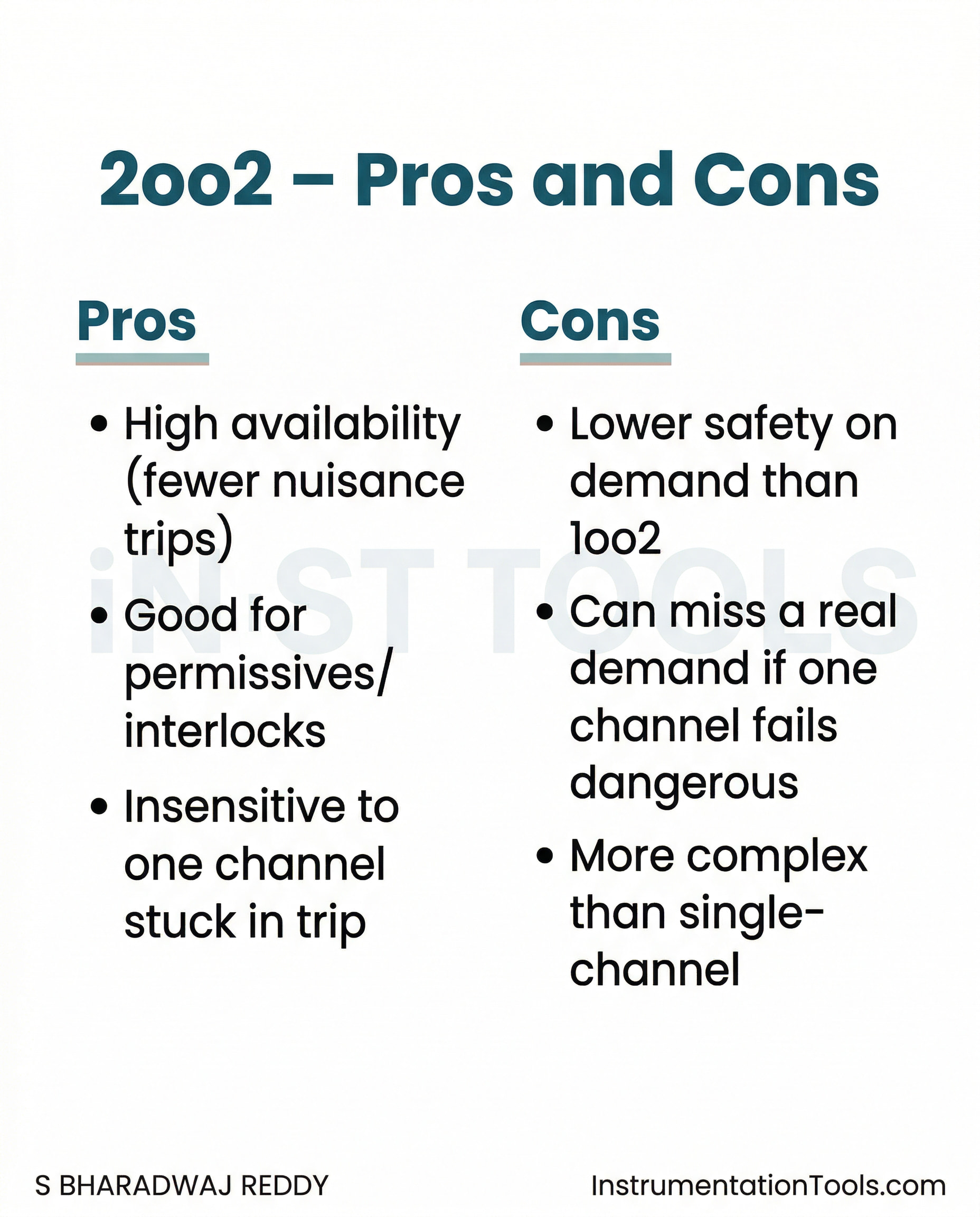

:light_bulb: Why industries use 2oo2?
:white_check_mark: Eliminates false trips
:white_check_mark: High confidence decision making
:white_check_mark: Suitable for critical shutdown conditions
:white_check_mark: Ensures process stability + safety
:gear: Where you’ll see it:
:small_orange_diamond: Emergency Shutdown (ESD) systems
:small_orange_diamond: Burner Management Systems (BMS) :fire:
:small_orange_diamond: Turbine protection systems
:small_orange_diamond: Boiler safety interlocks
:small_orange_diamond: High-pressure / high-temperature trips
:bar_chart: Real Example:
Two pressure transmitters monitoring a line:
:right_arrow: Trip happens ONLY if both detect high pressure
:right_arrow: If one gives false signal β†’ system ignores it

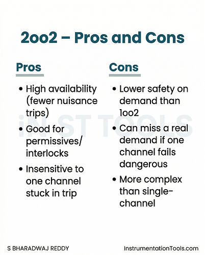

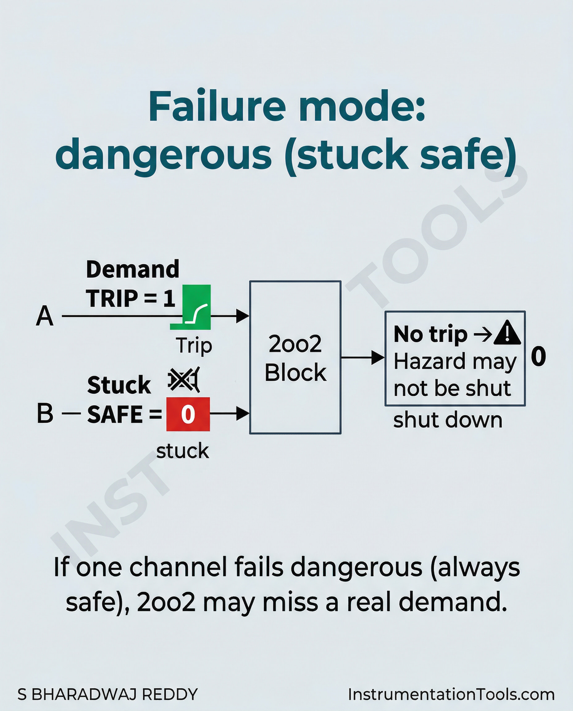

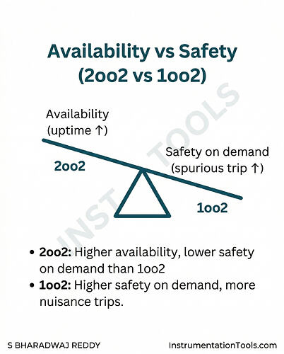

:prohibited: Limitation:
:cross_mark: Reduced availability (one fault = no action)
:cross_mark: Not suitable where uptime is critical

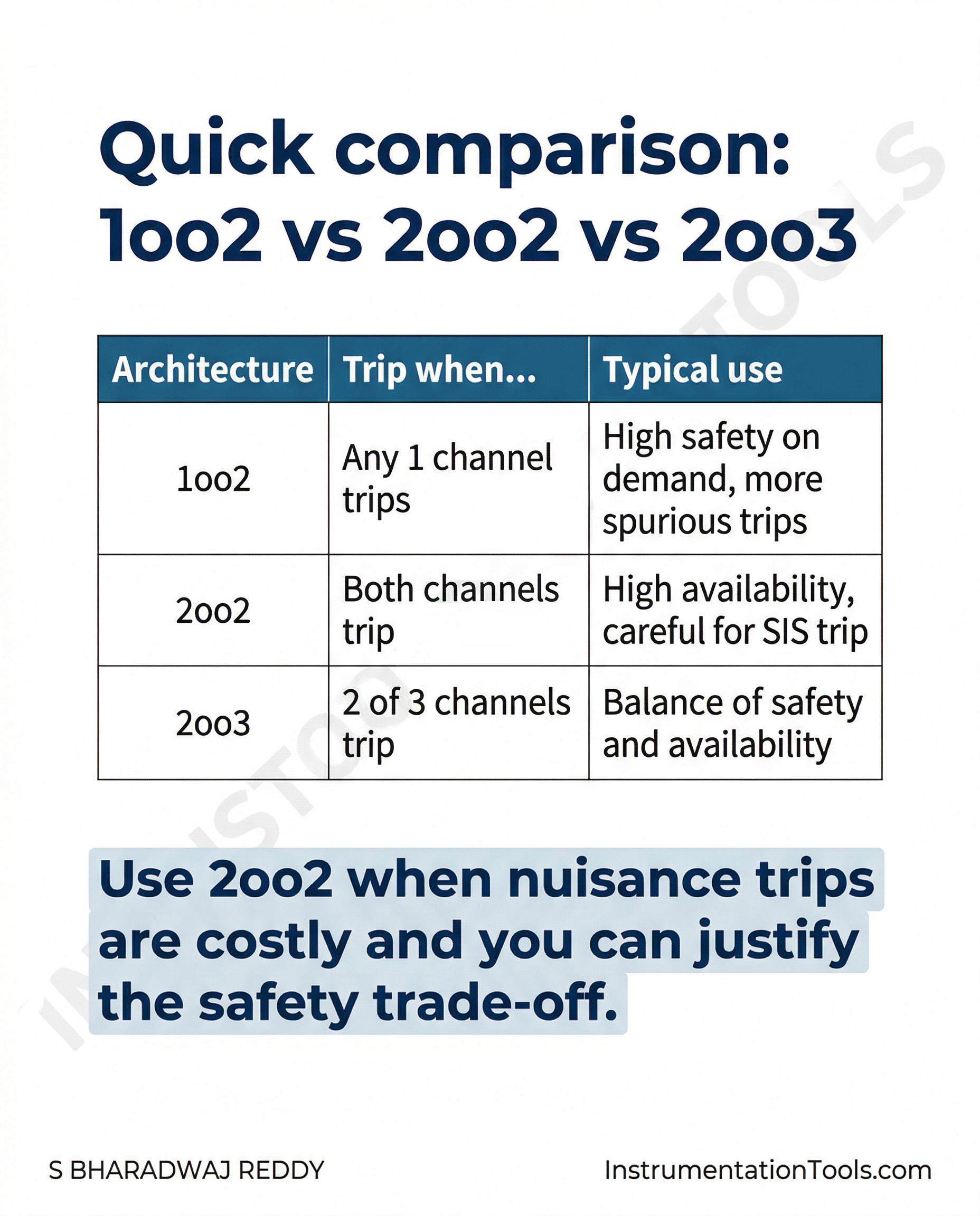

:counterclockwise_arrows_button: Comparison Insight:
:small_blue_diamond: 1oo2 β†’ More availability, less safety
:small_blue_diamond: 2oo2 β†’ More safety, less availability
:small_blue_diamond: 2oo3 β†’ Balanced (most commonly used)
