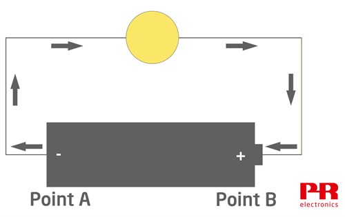

To illustrate Ohm’s Law, we will have a look at a typical AA battery:
The charge at the left terminal, (Point A) is negative compared to the charge at right terminal, (point B). In this battery, the difference in charge, (the voltage), is 1.5 V.
When a circuit is connected to the battery, it creates a path for electrons to flow from the negative terminal to the positive terminal. The lamp in the following circuit has a resistance of 5 Ω. This resistance regulates the amount of current flowing through the circuit.
Current = Voltage/Resistance, so the current flowing around the loop is 1.5 V /5 Ω = 0.3 A.

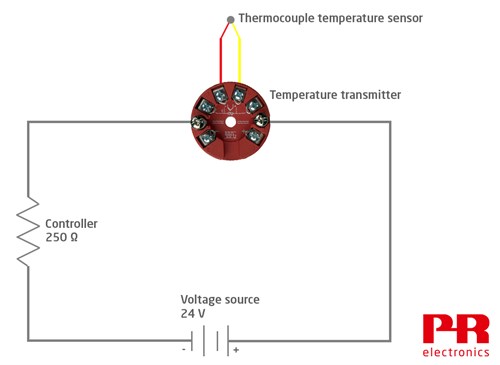

The loop transmitter
A loop transmitter measures a process variable, and regulates the loop current between 0.004 and 0.02 A, (4 mA…20 mA), by varying the opposition to current flow of the loop. Loop transmitters can measure nearly any process variable, for example temperature, pressure, level, or flow.
Also Check : 4-20mA Transmitter Animation
In the example below a loop transmitter measures a temperature sensor. The transmitter is programmed to regulate loop current flow between 4…20 mA as temperature changes from 0…100°C.
A process controller is also wired into the loop in order to measure loop current. The resistance symbol in this drawing symbolizes the controller; most have a fixed resistance of 250 Ω. The loop wire itself has some resistance as well, which should be considered when calculating a loop budget (more on that further down).
Current is common in a series circuit, so the loop current regulated by the transmitter and the current that is measured by the controller are identical.

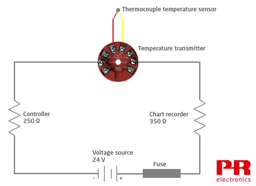

Loop budget
In the previous example, the transmitter regulates current flow on a loop that is powered by 24 V, and has one other device, the controller, wired into the loop.
Now, if we add a chart recorder to the loop, we have to find out if the loop will still work correctly with the additional 350 Ω resistance. To do this out, we calculate a loop budget.
How to make a loop budget:
First, we determine the maximum current in the loop. In this example, the transmitter is configured to increase loop current to 23 mA if a sensor error occurs. Therefore, the maximum current throughout the loop is 0.023 A.
Ohm’s Law states: Voltage = Current x Resistance. Therefore:
  • The controller loop voltage requirement is: 0.023 A x 250 Ω = 5.75 V .
  • The chart recorde r loop voltage requirement is 0.023 A x 350 Ω = 8.05 V .
The transmitter data sheet shows it requires at least 8 V to energize.
Finally, the lenght of the wire has to be considered. In this example, the distance between transmitter and controller/chart recorder is 40 meters. Thus, the total loop wire length is 80 meters. Assuming wires with a cross sectional area of 0.445 mm² are used, the total loop wire resistance is 10.7 Ω. Using Ohm’s Law: 0.023 A x 10.7 Ω = 0.25 V .
Now, subtract all the voltage drops from the loop voltage source:
Loop voltage 24 V
Voltage required by the controller -5.75 V
Voltage required by the chart recorder -8.05 V
Voltage required to energize the transmitter -8 V
Voltage required by the loop wire resistance -0.25
Voltage remaining to power other loop loads 1.95 V
After calculating our budget, we now know that this loop has more than enough voltage to drive 23 mA through all loop loads in case of a sensor error occur.

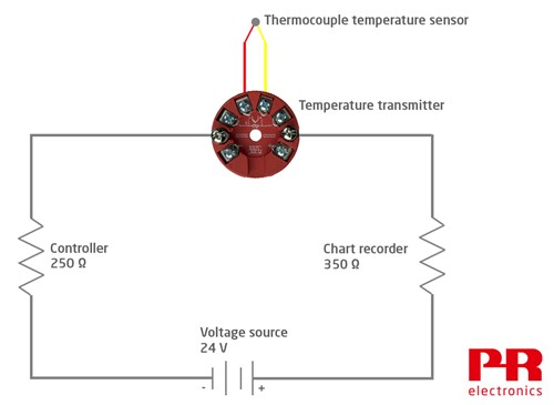

Fuse protection
The loop should always be protected from short circuit current by adding a fuse to the loop. This fuse protects the loop from excessive current, if a short circuit occurs that bypasses the 4…20 mA current regulation provided by the transmitter. Loop current will drop to 0 mA if the fuse blows, as a result the controller and chart recorder will detect this unusually low current value as error.

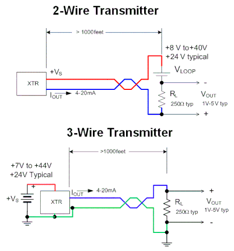

2-wire transmitters vs. 4-wire transmitters
The transmitters discussed so far are so-called “2- wire” transmitters. A 2-wire transmitter is energized by the loop power supply, which is why it is sometimes called a “loop powered” transmitter.

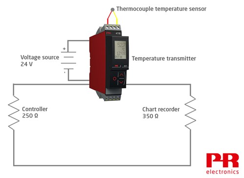

However, depending on your needs, 4-wire transmitters can be the better choice.
In this example, the 24 V source is connected to the transmitter. Some of its power is used to directly energize the transmitter, while additional power is used to energize the 4…20 mA current loop.
Some advantages of 4-wire transmitters:
  • There is enough power available to allow additional transmitter features, like contact outputs and an integral display
  • Enough power is available to allow a higher level of sensor excitation; e.g., nearly all load cell transmitters are 4-wire transmitters, because each load cell typically requires 10 V at 29 mA excitation
  • 4-wire transmitters can be energized by AC or DC voltage, while loop powered transmitters are energized by DC voltage only

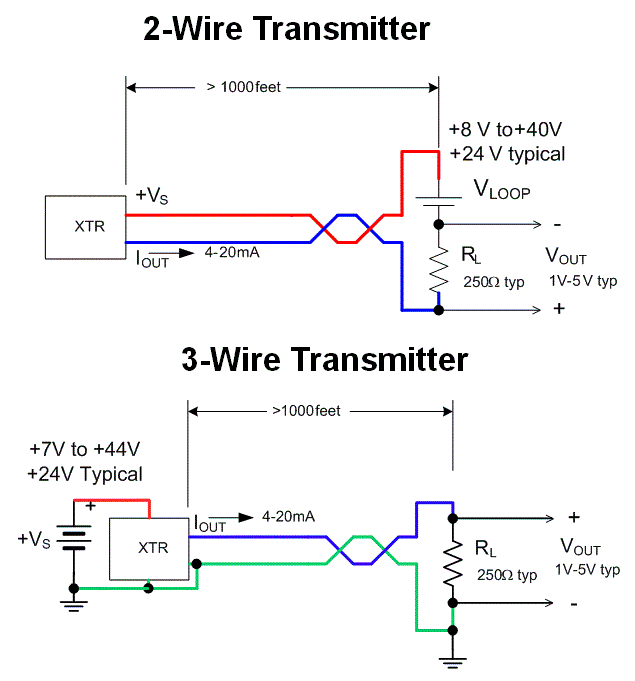

2-wire 4-20mA Transmitter:
  • Accepts loop-supply from 4-20mA receiver
  • Sinks a return current between 4-20mA
3-wire 4-20mA Transmitter:
  • Accepts power and GND from a local supply.
  • Sources an output current between 4-20mA.
