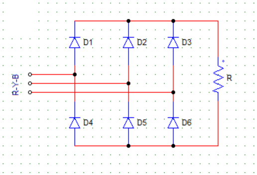

A 3-phase 6-pulse diode rectifier is shown below with phase sequence R-Y-B.
The negative group of diodes (D4, D5, D6) conduct in sequence (from ωt = 0°)
A. D4-D5-D6
B. D5-D6-D4
C. D6-D5-D4
D. D6-D4-D5
Answer: B
