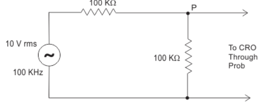

A CRO probe has an impedance of 500 kΩ in parallel with a capacitance of 10 pF.
The probe is used to measure the voltage between P and Q as shown in figure.
The measured voltage will be
A. 3.53 V.
B. 4.38 V.
C. 4.54 V.
D. 5 V.
Answer: B
