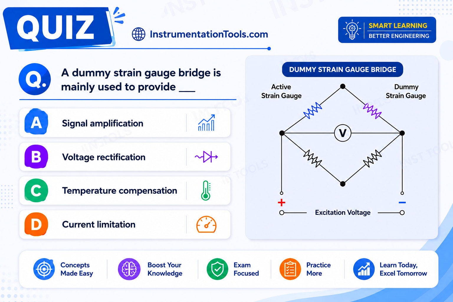

A dummy bridge employing strain gauge provides ___
A dummy bridge employing strain gauge provides ____
A. Signal amplification
B. Voltage rectification
C. temperature compensation
D. Current limitation
Answer: C
A dummy strain gauge bridge is mainly used for temperature compensation. The dummy gauge is not subjected to mechanical strain but experiences the same temperature conditions as the active gauge. This arrangement cancels resistance variations caused by temperature changes, improving measurement accuracy in strain gauge bridge circuits.
