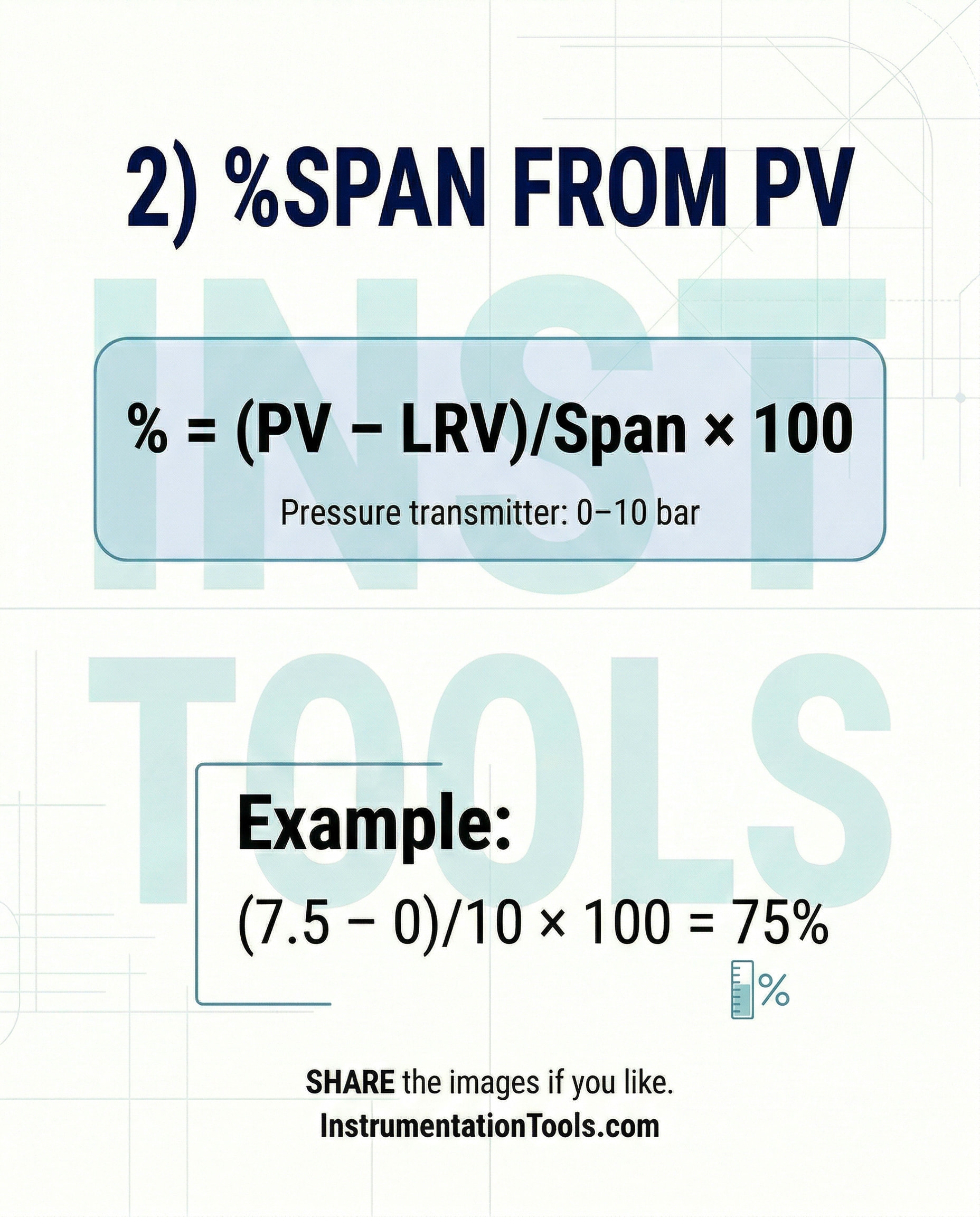

  2. %Span from PV
    % = (PV − LRV)/Span × 100 = (7.5 − 0)/10 × 100 = 75%

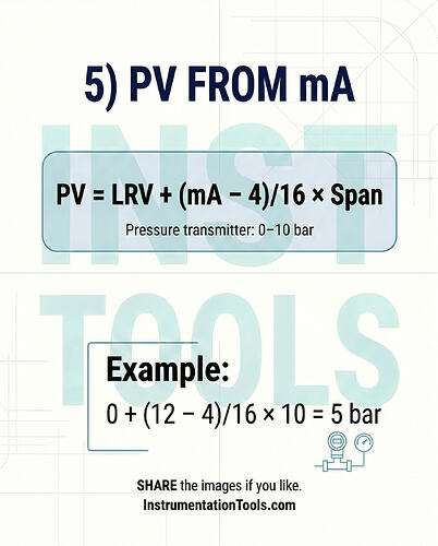

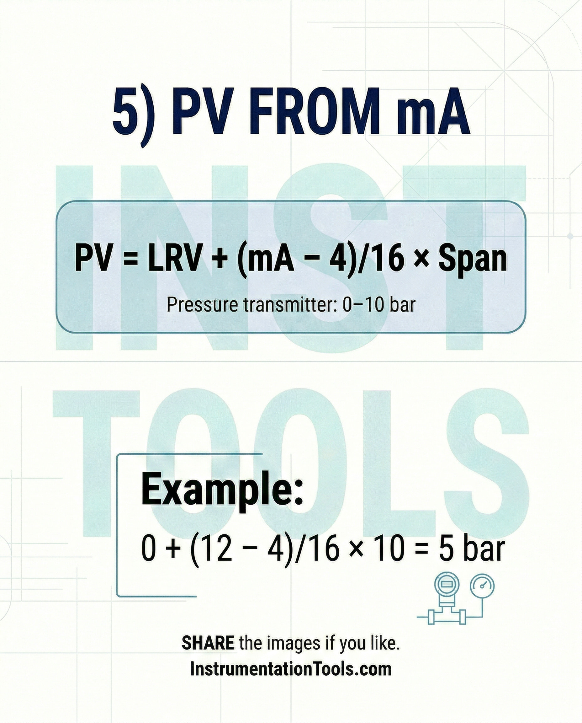

  5. PV from mA
    PV = LRV + (mA − 4)/16 × Span = 0 + 8/16 × 10 = 5 bar

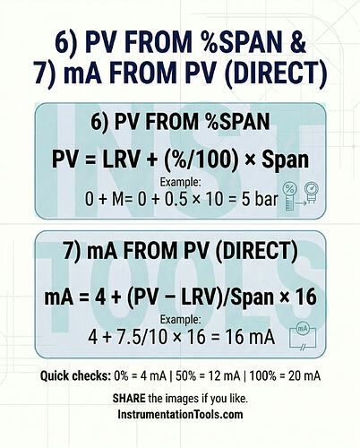

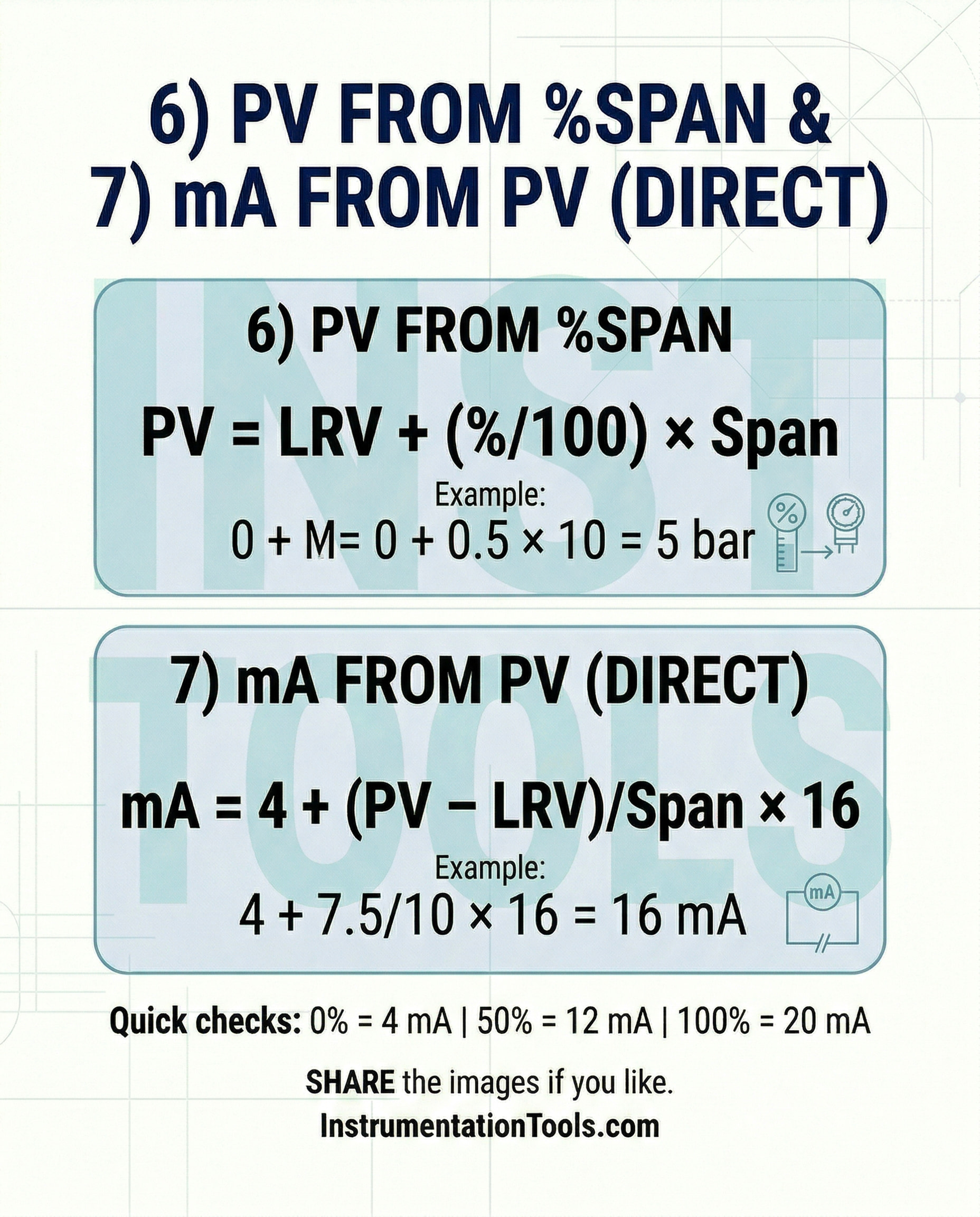

  6. PV from %Span
    PV = LRV + (%/100) × Span = 0 + 0.5 × 10 = 5 bar
  7. mA from PV (direct)
    mA = 4 + (PV − LRV)/Span × 16 = 4 + 7.5/10 × 16 = 16 mA
