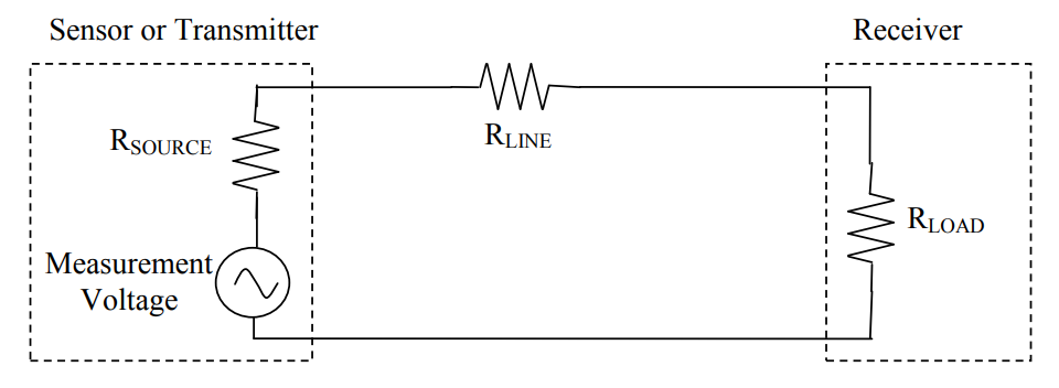

A typical voltage loop is shown in Fig.
Voltage Loop
RSOURCE is the internal impedance of the voltage source, the sensor or signal conditioner. The impedance of the signal lines is represented by the lumped component RLINE and RLOAD is the impedance offered by the receiver.
The sensor, line and receiver impedances form a voltage divider such that the voltage measured by the receiver is the measurement or source voltage minus the combined drop across RSOURCE and RLINE.
For this reason the input impedance of the receiver is made very high in comparison to the source and line resistances so that the current in the loop and hence the voltage drops across RSOURCE and RLINE become insignificant. So voltage-mode loops operate at very high impedances.
