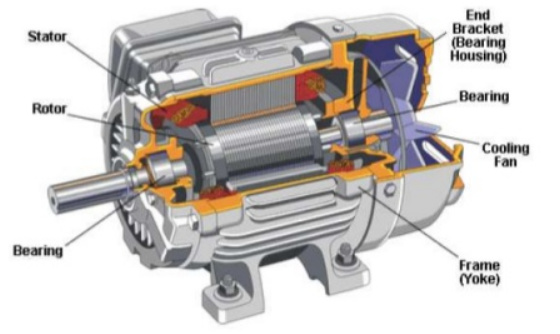

Electric machines are classified into two categories D.C. and A.C. motors, the basic parts for each type will be different for each type as follows:
AC Motor Basic Parts:
The basic parts for AC motors are as follows:
- Enclosure
- Stator
- Rotor
- Bearings
- Conduit Box
- Eye Bolt
1- Enclosure
The enclosure consists of a frame (or yoke) and two end brackets (or bearing housings).
A motor’s enclosure not only holds the motor’s components together, it also protects the internal components from moisture and containments. The degree of protection depends on the enclosure type. In addition, the type of enclosure affects the motor’s cooling. There are two categories of enclosures as follows:
