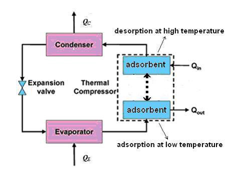

Principles of adsorption refrigeration
Like the mechanical vapor compression refrigeration cycle and the absorption refrigeration cycle, the adsorption refrigeration cycle can accomplish the removal of heat through the evaporation of a refrigerant at a low pressure and the rejection of heat through the condensation of the refrigerant at a higher pressure.
The pressure difference in the adsorption refrigeration system is created by adsorption and desorption of refrigerant vapor by adsorbent at low temperature and at high temperature respectively.
In comparison with mechanical vapor compression systems, adsorption systems have the benefits of energy saving if powered by waste heat or solar energy, simpler control, no vibration and lower operation costs.
