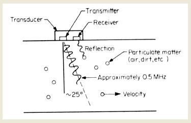

Doppler ultrasonic flow meter operate on the doppler effect. In Doppler effect, One transducer transmits an ultrasonic beam of 0.5Mhz into the flow stream.
Liquid flowing through the pipe must contain sonically reflected materials such as solid particles or air bubbles. the movement of these materials alters the frequency of the wave reflected onto a second receiving transducer.
The frequency shift is linearly proportional to the rate of flow of materials flowing in the pipe.
