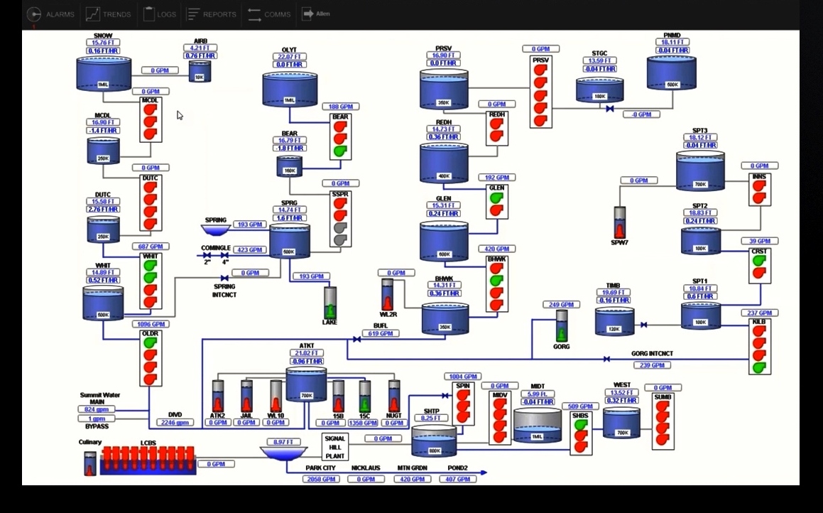

- The basic purpose of an HMI is to allow easy graphical interface with a process.

These allow an operator to use simple displays to determine machine condition and make simple settings.
The most common uses are,
- display machine faults
- display machine status
- allow the operator to start and stop cycles
- monitor part counts
These devices allow certain advantages such as,
- color coding allows for easy identification (eg. red for trouble)
- pictures/icons allow fast recognition
- use of pictures eases problems of illiteracy
- screen can be changed to allow different levels of information and access
