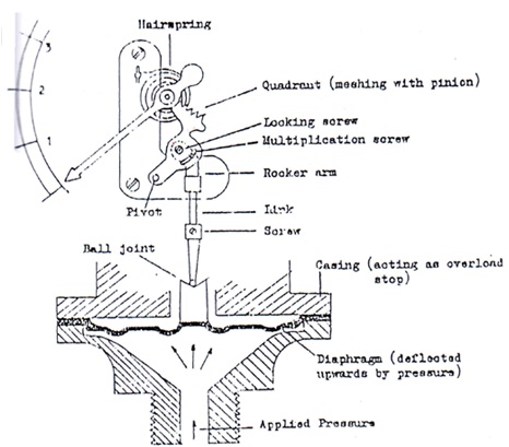

Pressure gauge with diaphragm is pressure gauge which uses diaphragm to measure pressure. The meaning of diaphragm is a material which easy to bend or so-called membrane, which is usually made of thin metal, leather, rubber, clan, etc.
The working principle pressure gauge with diaphragm is shown in Figure 1 based on the resilience properties of metal / thin plate due to the curvature of iteration pressure at membrane plane, the membrane device is used to measure the difference of two different pressures.
The ability of pressure gauge with diaphragm to read the different pressure is based on:
- The area of membrane.
- Thick membrane.
- Type of membrane material.
