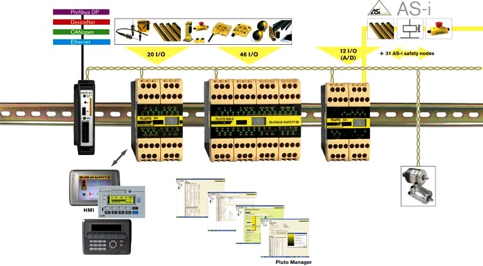

Using a Safety PLC for a Safety Circuit-
A safety PLC is different from a conventional PLC in many ways, such as:
Redundancy of onboard devices which are continuously monitored by a watchdog timer.
Continuously monitors inputs with a smart circuit to detect failure.
Added safety circuitry between the output switching device and an actual device, which will detect system failure and facilitate a safe shut down by going back to a known state.
Major savings on field wiring, Remote I/O capability with safety, Good diagnostic capability can be easily achieved by Safety PLC.
