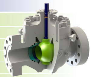

In Top-entry Ball Valves, Full in-line maintenance in the vertical or horizontal position. The bolted construction allows disassembly on site for inspections and possible repairs.
Clearing the bonnet off the valve allows free access to the ball and the seats, which can simultaneously be taken out with special maintenance tools.
Reduced number of potential leak paths.
After maintenance, the valve can be fully retested without pipeline pressure.
Sized to withstand external loads from the pipeline even when the bonnet, the ball and the seats are removed for maintenance.
It Can be welded directly onto the pipeline assembly.
Available for all industries and applications
