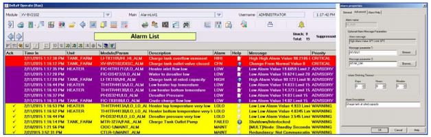

Based on the performance you need your alarm system to achieve and the nature of your process, you may want to implement more advanced alarm handling solutions , such as the following:
• Alarm Shelving : A safe, secure way to temporarily disable a nuisance alarm until the underlying problem can be corrected. Most control systems have inadequate mechanisms to properly control temporary alarm suppression . Computerized lists of shelved alarms, with time limits, reminders, and auto-re-enabling are necessary. It must be impossible to temporarily suppress an alarm and then forget about it—a very common and dangerous occurrence throughout industry.
