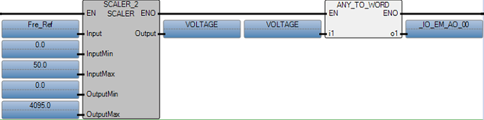

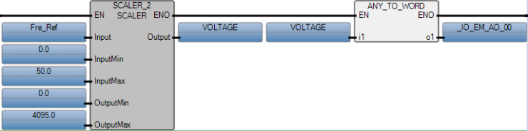

Step 3) Use following SCALER block to scale Analog Ouput.
Step 4) In following example,
Here,I want to give Frequency Reference to VFD in the range of O-5O Hz as per requirement.So I put Fre_Ref in Input,O.O in InputMin,5O.O in InputMaxrespectively.
Analog Output _IO_EM_AO_OO has O.O to 4O95.O raw count.But Output (Voltage) of SCALER Block is in Real data Type.So convert it to Word as Analog Output requires Word.
Note: You can measure voltage at Analog terminals i.e. -DC24 & AO-O on PLC.

This is the way we can SCALE Analog Output In Micro820 PLC in the range of O-1OV.
