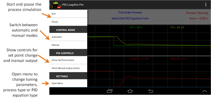

1- Overview
Description of the control options:
Run: Start the process simulation
Pause: Pause the process simulation
Automatic : Switch the process to automatic mode.
Manual : Switch the process to manual mode.
Show Set Point control : Shows the slider to set the set point.
Show Manual output control : Shows the slider to set the PID output in manual mode.
Tuning Constants : Changes the P, I and D constant gains.
System Configuration : Opens the configuration screen to change the PID equation form, the process type and the process dynamics.

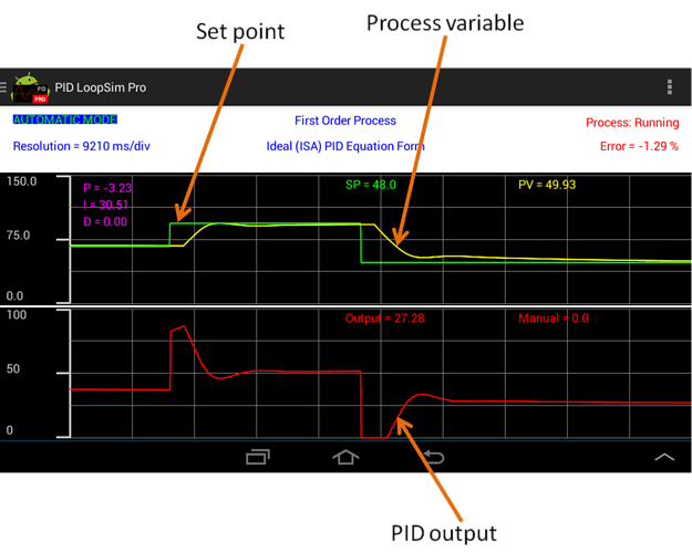

Automatic mode:
  • Open the menu and Tuning Constants . Enter the PID gains. You can change the units of the PID gains by touching them and selecting the new units.
  • Touch Accept button to close the PID tuning window.
  • Close the Manual Control slider and open the Set Point slider. Touch the Set Point slider to enter a new set point value. In the trend graphic, the green line will show the new set point.
  • Touch “Automatic” to switch the control to automatic mode.
  • See the response of the process variable (yellow line). Make set point changes by touching the set point slider and see the response of the process.

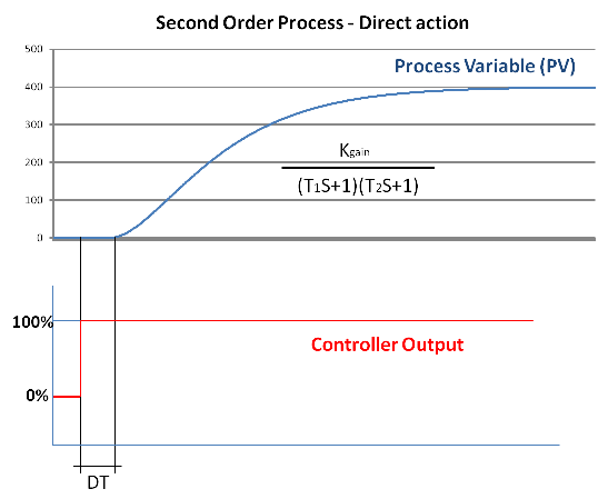

A- First Regulating Process - 1st order:
Maximum PV : Steady state value of the process variable (in engineering units) when the PID controller output is 100%.
Minimum PV : Steady state value of the process variable (in engineering units) when the PID controller output is 0%.
Lag Time (TC) : Time constant of the process. 63.2% of process step response (see graphic below).
Dead Time (DT) : Process delay (see graphic below).

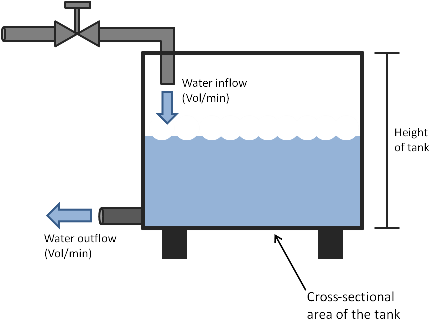

C- Integrating Process (tank level control):
Max Inflow Rate : Water flow rate (units: volume/minute) when the valve is 100% open.
Output Flow Rate : Flow rate of the water leaving the tank (see graphic below).

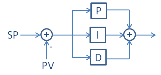

B- Parallel PID equation:
Parallel PID equation377x69

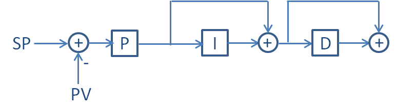

C- Series PID equation:
Series PID equation414x61
