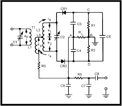

At resonance, what is the phase relationship between tank current and primary voltage?
A. Tank current leads primary voltage by 90 degrees
B. Tank current lags primary voltage by 90 degrees
C. Tank current and primary voltage are in phase
D. Tank current and primary voltage are out of phase
Answer: C
