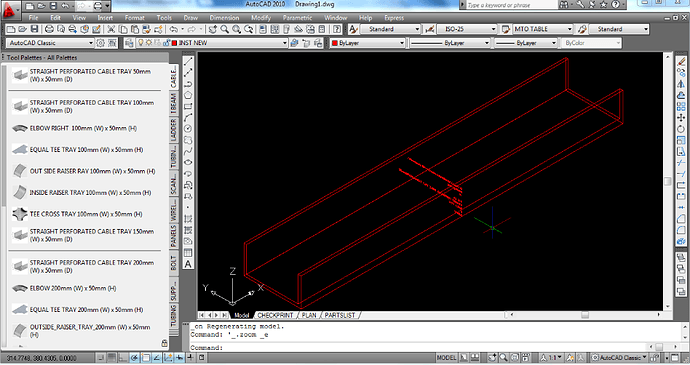

Adding and editing components becomes easier in AutoCAD with tool palettes. The tool palettes contain blocks. With the parameter action Polar Stretch, you can just type the length you desire and AutoCAD will stretch the tray to that length.
Furthermore, you can rotate the block before you place it. In my opinion the tool palettes are user friendly. Even a novice can use them. Moreover you can insert blocks into your drawing with drag and drop. It is easy to access from tool palettes.
Open and close the tool palette by pressing CTRL+3. You can auto-hide the tool palette in the vertical blue area of the tool palette, simply click on the symbol <>I. By doing that, you leave more space in the drawing area.
On the image above you see what you get a Isometric view of Cable Tray.
You can easily place these elements in your drawing.
