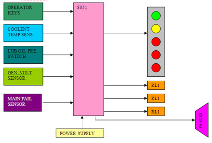

It provides reliable and accurate start/stop operation of the D.G.SET with AUTO LOAD CHANGE OVER FROM D.G.AND MAINS and FAULT ANNUNCIATION for the safety of the D.G. SET
This project is a proper solution to the above problem as name stands AUTO MAIN FAILURE SOLUTION (AMFS). What it dose ?
It senses the main supply failure and give starting pulse to diesel generator through start solenoid.
If the generator dose not get started with the first attempt ,it will make two more attempts to start the D.G.set. When it fails to start with three attempts, it will sound an alarm with indication “ STRAT FAIL”.
Even if the engine starts normally but alternator dose not produce the required voltage, in that case “ALTERNATOR FAIL” signal will come.
After the gen set has started normally and it has come to normal voltage ,it will switch on its breaker automatically (auto-on-load).
During normally running condition, if any fault occurs on the engine side, it will stop automatically with the respective fault and buzzer indication.
when the main supply get re-stored, it will change over to mains and switch off the D.G. set automatically.
It can be operated on both auto or manual mode.
