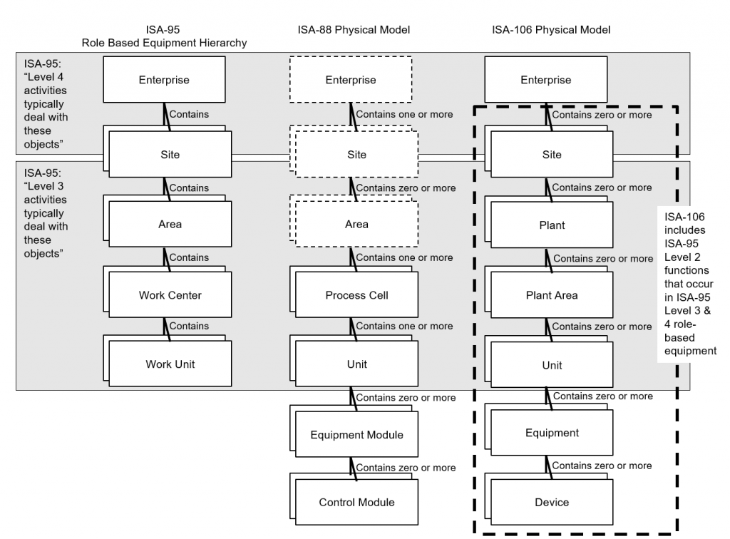

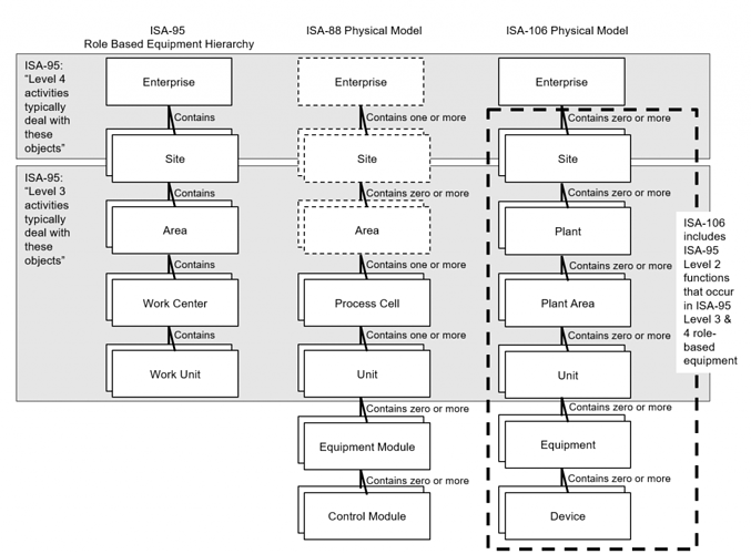

Figure 1 Comparison of several ISA plant structural models (ISA-95/88/106

True, the reflection on industrial plant structures is available in Automation Engineering for years. Structures for entire plants, beginning from the Site level drilled down to the Device or Control Module levels can be created. One of the key features, module-based engineering, enabled the use of parent-child relationships on Modules allowing them to be handled and organized in the Engineering Library and updated later when the parent was changed.

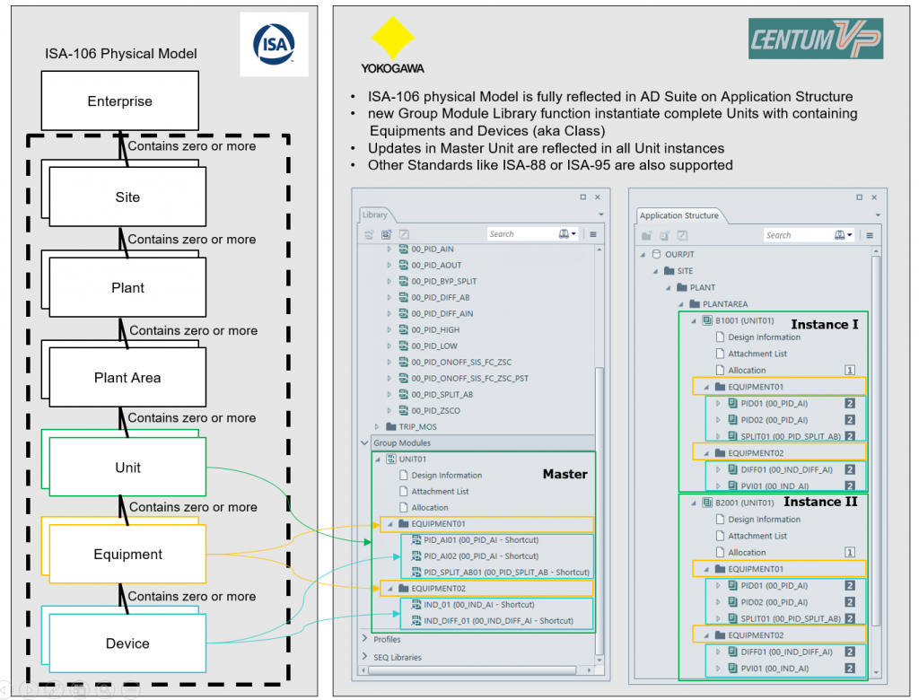

But this was really not enough. According to the ISA plant structure modules (Figure 1), just providing modules is not enough, getting all the above-mentioned advantages. For all use cases and flexibility in the lifecycle of a process plant, a grouping of these modules is needed. A Group Module function or in your terms a Unit library can be designed and configured in the Engineering Library (see figure below). The entire unit can be instantiated to one or more unit instances with a few mouse clicks. The Class Modules in the unit are inherited from the existing Class Module library and follow the same parent-child procedure.
Let’s summarize. With this Group Module function, plant structure standardization reaches a new era. Entire units can be created, instantiated and updated in an easy graphical way and true standardization becomes possible. Copying units within a plant or even to another plant can be done by drag & drop. Modification of instances is also easy by adding additional modules to the instance.
Figure 2 AD Suite library support now standardizing up to UNIT level
Yokogawa has recognized this need and implemented it completely in the new module based Automation platform AD Suite.
