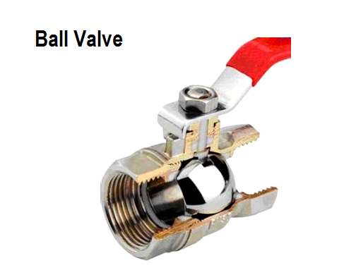

Ball Valve Principle, Advantages and Disadvantages
Ball valves are a quick opening valves that give a tight shutoff. When fully open, a ball valve creates little turbulence or resistance to flow.
The valve stem rotates a ball which contains an opening. The ball opening can be positioned in the fully open or fully closed position but must not be used to throttle flow as any abrasive wear to the ball will cause leakage when the valve is closed.
Ball valves are considered high recovery valves, having a low pressure drop and relatively high flow capacity.
