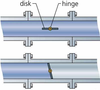

Swing Check Valves
This type of check valve uses a hinged mounted disc that swings open and closed with flow. They can be used in the horizontal and vertical (flow upwards) position. The swing check is the most commonly used design of check valve as it does not restrict flow.

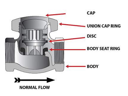

Lift or Piston Check Valve
This type of check valve uses a piston rather than a hinge-mounted disc to prevent the reversal of flow. This provides a cushioning effect during the operation of the valve. They must only be used in a horizontal position. Lift check valves, like globe valves, are flow restricting; therefore, they are generally used as companions to globe valves.

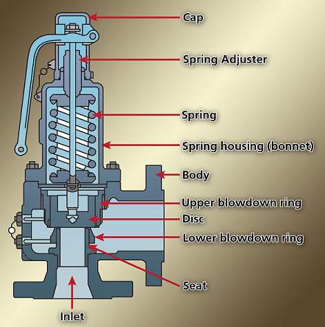

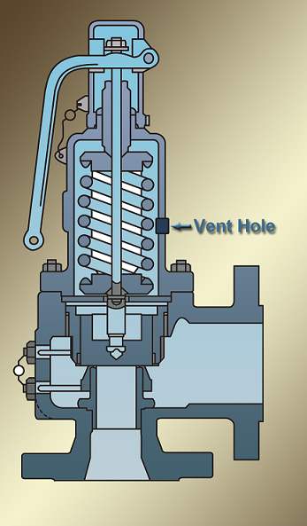

Pressure relief valves are designed to open automatically at a pre-determined set pressure level of system pressure and to achieve a rated relieving capacity at a specified pressure and temperature above the set-point (over-pressure) before re-closing at a pressure below the opening point (blowdown). The simplest and most reliable type of pressure relief valve, even some four-hundred years on from the first design, is the spring-loaded design where a spring force opposes the system pressure acting on the valve disc. When the system pressure rises above the level of the spring force, the valve opens. This valve type may also be fitted with a bellows for better emission control performance.
The significant elements of all spring-loaded pressure relief designs are the springs and the seats. The springs must provide the desired compression rate and a reasonable range of adjustment. They must also fit into the valve bonnet and stay within the design perimeters. The seats may be flat or angled, metal or soft. As the seat area usually defines the load transmitted to and from the spring, very high precision is essential to ensure proper valve operation.

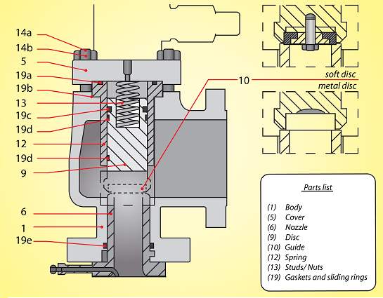

A second type of valve, which is more sophisticated and offers operating advantages in selected applications, is the pilot-operated pressure relief valve.
This type of valve consists of a main valve and a pilot valve. The pilot responds directly to system pressure and communicates with the main valve. As with the spring-loaded valve, many unique models exist. However, some common design features of pilot-operated pressure relief valves include the sensing line, pilot valve, and main valve.
The sensing line is either connected to the valve inlet or a remote location and conveys system pressure to the pilot.
The pilot valves senses and responds to the system pressure. The pilot is the controlling member of the valve system and determines all of the operating characteristics of the valve. It consists of many small parts and passages and usually relies on elastomer seals for operation.
The main valve operates in response to the pilot and provides the main rated flow capacity to reduce excess pressure.

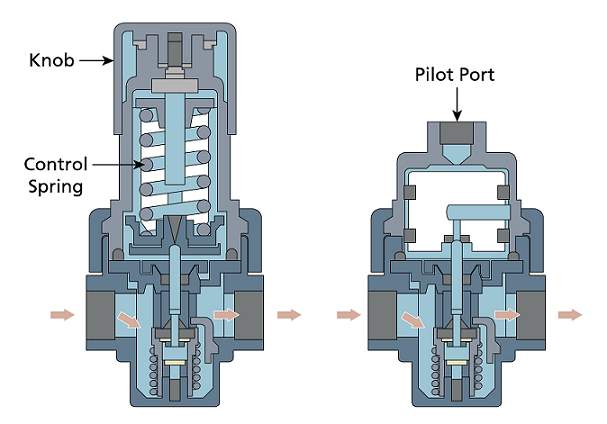

Finally, regulators often are called upon to manage operating conditions other than pressure, such as temperature or flow. A regulator will be either direct- or pilot-operated. Direct-operated regulators are simple, single-minded devices intended for a specific application within a particular range of pressures.

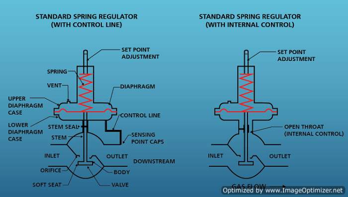

Direct-Operated Regulator
In a direct-operated pressure regulator, managed pressure is applied to some internal surface within the valve. The resulting force is transmitted to the modulating parts of the valve and balanced by a second force applied within the valve. In many cases, the second force is adjustable to establish the set-point. Movement of the modulating parts inherently involves a change in the balanced forces and thus a change in the managed pressure. The more the demanded flow deviates from what the regulator was experiencing at the time it was first adjusted, the more the pressure must deviate from set-point.
Pilot-Operated Regulator
A pilot-operated regulator consists of a pilot section and a slave section. Two flows are managed by the valve. The first, which is by far the greater proportion of the total flow, is managed by the plug and orifice in the slave section. The second, the pilot stream, is managed by the pilot section. The pilot section may have its inlet connected to the immediate upstream side of the main valve or may source its flow from a higher pressure space. The pilot section’s modulating portion is available in all dispositions and functions of direct-operating regulators.
