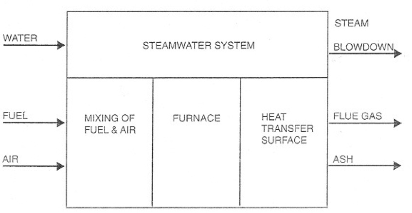

A steam boiler is composed of 2 basic systems as shown in Figure 1. One basic boiler system is the water-steam system which is known as boiler waterside.
In waterside of boiler, water is heated and released by movement via water tubes, then water is transformed to steam, and also it retains as steam in the system.
Figure 1: Basic Boiler System Diagram
(Source: Book-Boiler Control System Engineering-G.F Gilman)

The other basic boiler system is the fuel-flue gas-air system. This system is as well-known as the boiler fireside. This specific system supplies heat which is transferred into boiler fireside system.
Fuel is the input for this system and to perform combustion or firing needs air and ignition system. The combustion air and fuel is as well-known as wind box. Ash and gas will be the output of this system.
