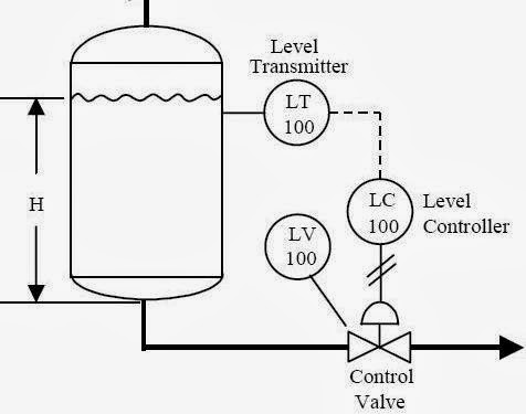

EXAMPLE:
In the above example the tank is filling with the pipe line above the tank and emptying through the bottom pipe line. The level of the liquid in the tank need to control for process purpose. So the control loop is designed here just to control the tank level.
The level or height of the liquid is the process variable here and the level transmitter (LT) is used to measure the process variable continuously.A level controller (LC) is used as controller and a level control valve (LV) is used to control the flow inside the bottom pipe line.
Here the control loop is working in following steps:
- First the level transmitter (LT) is measuring the level.
- The measuring value is transmitted to level controller (LC) through electrical signal.
- The controller decide what to do depending on set or desired value.
- Then the controller send required command to the level control valve (LV) through a pneumatic signal.
- Finally the control valve increase or decrease the flow as per controller signal.
