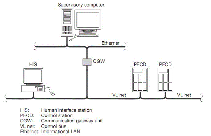

Architecture:
The hardware architecture of CENTUM CS 1000 has been shown below in given figure. The description of CENTUM CS 1000 has been given after subdividing it in some smaller areas as CPU, Battery Units, Power supply units, I/O Modules, communication cards, Human interface system (HIS).

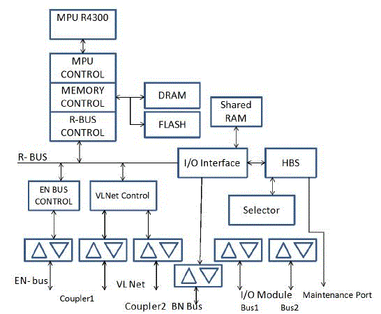

CPU:
INTERNAL BLOCK DIAGRAM OF CPU CARD
There are two models of CPU card: The CP701 for basic systems and CP 703 for enhanced systems. The basic system model has 8 MB of memory, while the enhanced system model has 16 MB. The model chosen depends on the type of system software used. The main memory is ensured of high reliability by error correction code (ECC).
The redundancy architecture of the CPU is referred to as a synchronous hot standby system, which is the fundamentally the same as that of the CENTUM CS, the only difference being the addition of the new error detection and protection functions.
These functions set write protected areas in each CPU card to protect the program and database areas against illegal address writing instruction from the other CPU card, and thereby prevents both card from failing due to illegal accesses caused by malfunctions in MPU. Other newly added functions include the memory management unit (MMU) and write protection which ensure data integrity, the parity check of addresses and data, the ECC memory, and a two wire signal self checker.

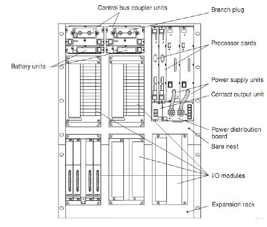

Nest Configuration:
The FCS nest is composed of VL Net couplers, battery units for backing up the CPUs’ main memory, a backboard, a power distribution board, and a ready signal output unit in addition to the CPU cards and power supply card. A FCS model has five I/O modules nest.
Figure Nest Configuration Power Supply Card:

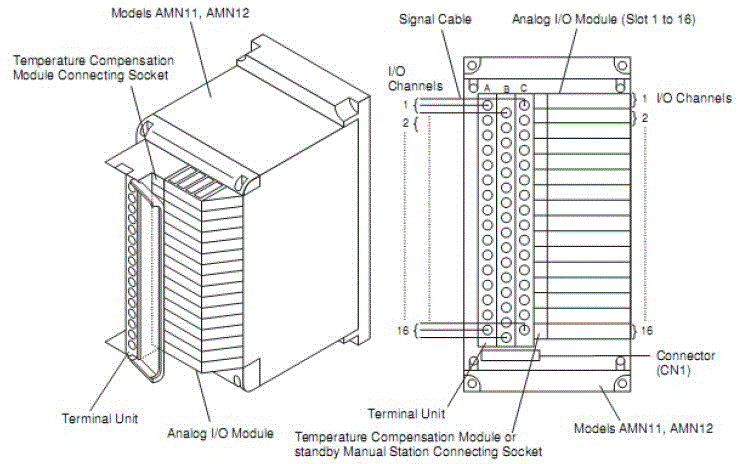

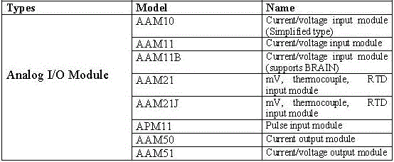

Analog Input Module:
List of I/O Modules Installable in Analog I/O Module Nest:
Wiring of Analog I/O Module:
Models AAM10, AAM11, AAM11B, AAM21, AAM21J, APM11, AAM50, AAM51
If output signal between 1 - 5V DC needs to be output to a recorder, etc., connect the Model AKB301 cable to the (CN1) connector. For example, to output signal from the terminal block TE16 to the recorder, connect cable Model AKB301 between CN1 and the terminal block.

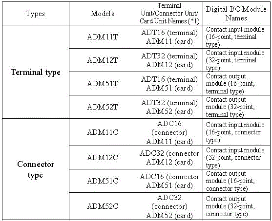

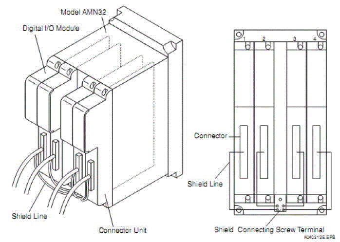

Digital I/O Module:
The digital I/O module is configured by the card unit and either the terminal unit or connector unit. It inputs and outputs 16 or 32 signal points and converts signals. Since the types or I/O signals are software-set, no control switch or knob is found on this module.
The table below shows the types of digital I/O modules.
Wiring of Digital I/O Module (Connector Type):
Digital I/O module (connector type)
Models ADM11C, ADM12C, ADM51C, ADM52C

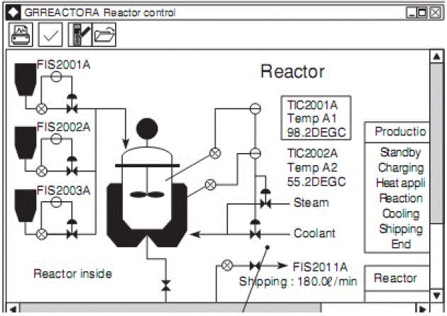

How the HIS looks like:
The human interface system programmed for a project/plan is designed in such a way that it would be easy for the operator to understand all the operations occurred in the plant. The example of visualization of a reactor control power plant has been given below:

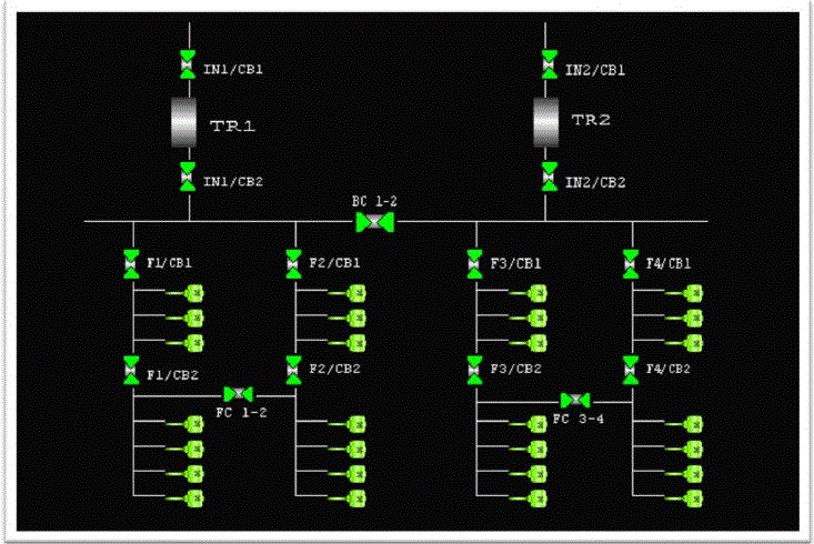

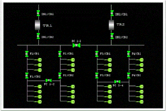

Example2:
Substation Automation : Visualization of typical substation comprising two incomers and four feeders.

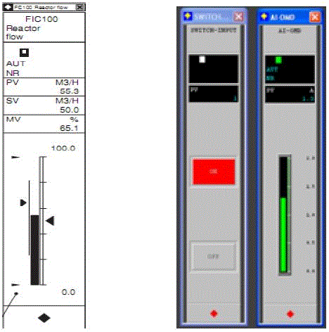

How the faceplate looks like:Faceplate window is a type of window, where the process variation, switch status has been displayed.
