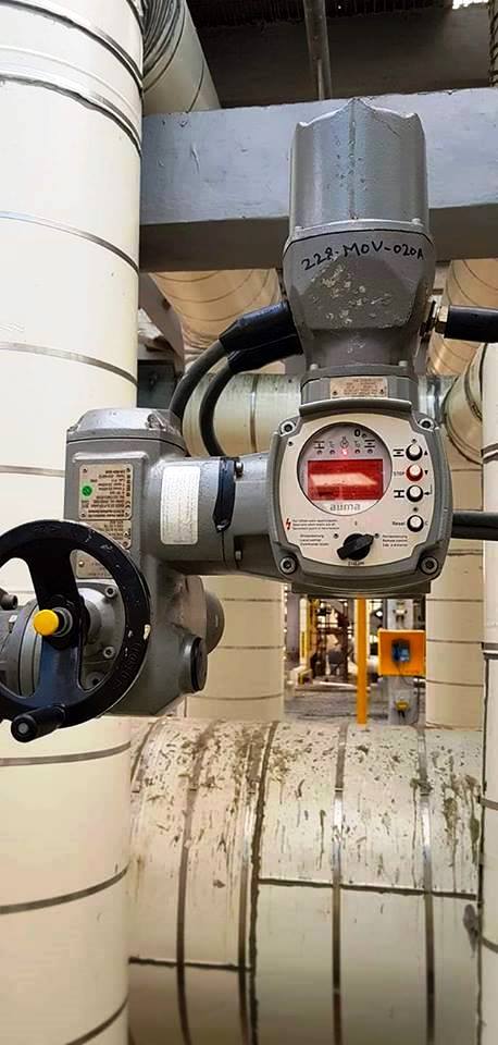

Motor Operated Valve (MOV) is one of the most important items in process and piping system. These valves are generally of large size and are used in different conditions.
Motor operated valves can be of various types e.g. Gate/ Ball/ Butterfly etc. with electric motor operated actuator for control. Make of motors and valves are different.
Motor operated valves are often called as On-Off valves also as they serve the purpose of full open or full close services in pipelines. For example cooling water lines, process pipelines where controlling of fluid is not required can use motor operated valves for turning flow on or off. These valves are not used for throttling purpose.
