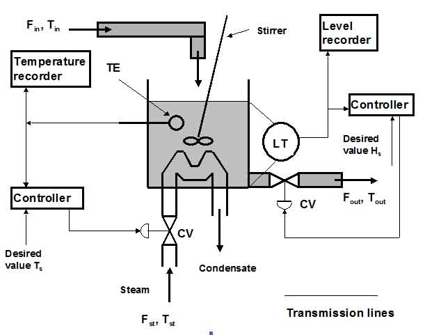

Let’s consider two systems for the control of temperature and level of liquid in a stirred tank shown in Fig. 1.1.
These two control systems have all elements inherent to every control system, namely:
- a process - the stirred tank;
- controlled variables - temperature of the effluent liquid (or temperature of the liquid in the tank) and level of the liquid in the tank;
- a transducer, a measuring instrument, a transmitter;
- a transmission line (electrical, pneumatic or hydraulic) that carries a measurement signal from a measuring instrument (or transducer) to a controller;
- a control signal from a controller to a final control element (for example, a control valve);
- a controlling device or a controller;
- a final control element - a control valve.
In Fig. 1.1 we used the following symbols and abbreviations:
CV - a control valve.
Fin, Fout,Fst- flowrates of inlet and outlet streams of the liquid, and steam, respectively;
Hs - a desired value (set point) of the liquid level in the stirred tank;
LT - a level transmitter;
TE - a thermocouple;
Tin, Tout, Tst - temperatures of inlet and outlet streams of the liquid, and steam,
respectively;
Ts - a desired value (set point) of the temperature in the stirred tank.
Figure 1.1. Process control systems for a stirred tank.

In general, process variables can be classified as shown in Fig. 1.2. Now we can give explanations of types of process variables with the examples from Fig.1.1.
Figure 1.2. Classification of process variables.
- Input variables reflect the effect of the surroundings on the process (Fin, Tin, Fst, Tst
- Output variables denotes the effect of the process on the surroundings (Fout, Tout, H)
- Manipulated variables can be adjusted freely by the human operator or a controller (Fst, Fout)
- Disturbances are not the result of an adjustment by an operator or a controller(Fin, Tin, Tst)
- Measured variables - their values can be directly measured by a measuring device (Fin, Tin, Tout, H)
- Unmeasured variables - their values are not or cannot be measured directly (in chemical processes - the feed composition for a distillation column).

A controller is an element that compares a current value of a controlled variable (the input variable for a controller) with a desired value (the set point) and takes appropriate control actions to adjust values of manipulated variables in the way to reach the desired value of process variable. In our example (see Fig.1.1) the controller changes flowrates of steam entering the heat exchanger and effluent liquid.
As the result of this action, the process variable (the temperature of the liquid in the outlet of the stirred tank in Fig. 1.1) changes in such a way, that it approaches closer to the desired value (set-point). This is a closed-loop or a feed-back control system. Feedback is an information about the status (or the magnitude) of the controlled variable which can be compared with its desired value.
A control system without feed-back is called an open-loop control system. In other words, if we remove the temperature transducer and level transmitter, controllers and control valves, or simply brake links between thermocouple and level transmitter and controllers, or between controllers and control valves (see Fig.1.1) and leave the tank not under control we will get an open-loop or unregulated system. In this case information about controlled variables (the temperature and level of the liquid in the tank) is not used for control of these process variables.
It is interesting to note that an unregulated system can be selfregulated. Assume that the flowrate of the inlet liquid suddenly has increased to another value. Since Fin>Fout, the liquid will be accumulated in the tank (the level will increase). Thus increased liquid level will inevitably increase the head of the liquid, which in its turn will increase the value of Fout. This will continue until that moment when Fin=Fout. After that, the level will be maintained on another value.
