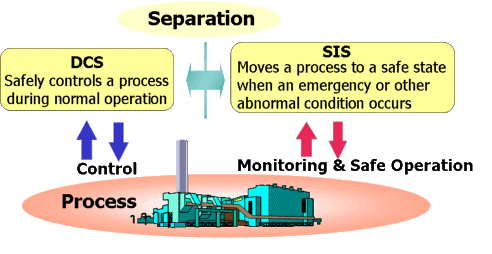

Basic Configuration of an SIS
The basic components of an SIS can be shown schematically
These are the sensors with associated signal transmission and power, logic solver with power supply, input and output signal processing, actuators and switching devices to execute the final elements. For an example of a typical features of an SIS.
