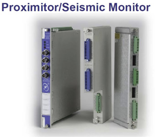

Proximitor or Seismic Monitor
The Proximitor or Seismic Monitor is a 4-channel monitor that accepts input from proximity and seismic transducers, conditions the signal to make various vibration and position measurements, and compares the conditioned signals with user-programmable alarms.
Each channel of the 3500/42M can be programmed using the 3500 Rack Configuration Software to perform any of the following functions:
•radial vibration
•thrust position and differential expansion
•acceleration and velocity
•acceleration 2 and velocity 2
•slow speed eccentricity
•shaft absolute measurements
•Circular Acceptance Regions (CAR)
•REBAM
•provides 4 to 20 ma recorder output.

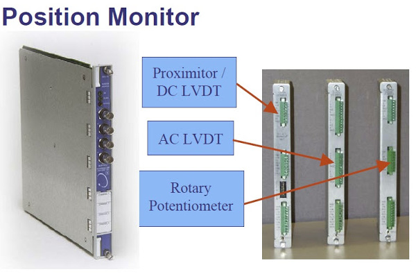

Position Monitor:
The 3500/45 Position Monitor is a four channel monitor that accepts input from proximity transducers, linear variable differential transformers (DC & AC LVDTs), and rotary potentiometers and uses this input to drive alarms.
The 3500/45 can be programmed using the 3500 Rack Configuration Software to perform any of the following functions:
•standard and nonstandard single ramp differential expansion
•dual ramp differential expansion
•complementary differential expansion
•case expansion
•valve position

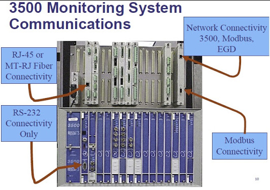

3500 Monitoring System Communication:
The 3500 Monitoring System allows communication through several interfaces, and can allow communication with more than one of these at a time. Examples of this connectivity include:
• temporary or permanent RS-232 or RS-422 connection to the back of the rack at the I/O interface (the RS-232 connection is only for the RIM I/O)
• temporary RS-232 connection to the front of the 3500/20 Rack Interface Module (RIM) or 3500/22M TDI (Transient Data Interface)
• network connection directly to 3500/22M TDI I/O or to the 3500/20 RIM through the communication gateway module
• serial and/or network connection to other Modicon Modbus or EGD (Ethernet Global Data) Gateway devices through the communication gateway module
• dynamic and static connectivity to the TDXnet™ Communications Processor for data collection by Data Manager® 2000 software or System 1™ Data Acquisition software
• MT-RJ fiber or RJ-45 twisted-pair Ethernet connection to the 3500/22M TDI for data collection by 3500 software or System 1™ Data Acquisition software
