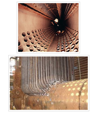

Bank tubes are provided in Bi Drum Boiler. Boiler Bank tubes have steam drum and mud drum.
Bank tubes are provided between these two drums.
It acts as a down commer and raiser between theses drums.
It supports the whole weight of the mud drums and down commers.
Any failure on these tubes Damage the near by tubes. so it must be attended immediately

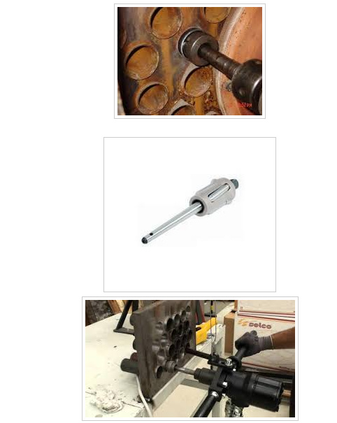

The bank tubes are held inside the Drum holes by expanding it with a expander. while expanding the tube expands and deform plastically and the drum being in elastic condition exerts force to hold the tube against pressure.
while expanding the bank tube, its thickness reduces 7 to 11 % this indicates the good joint.

The main reason for bank tube failure is due to inadequate expansion. More than 1000 bank tubes will be there and its difficult to measure the tube thinning for all the tubes after expansion. tube thinning measurement is done randomly for 200 tubes after expanding all the tubes.the requires torque is applied using expander to all the tubes and its taken for granted that all the tubes are expanded

The expansion leakage can also attended by re expanding all the tubes but the tube thinning must be limited to 13 to 15 %. More than that the tube cause brittle and leads to failure
