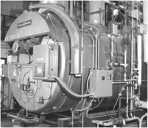

The CB-Hawk boiler management control system (’’‘Figure 1’’’) combines the functions of a flame safeguard programmer with those of operating and firing rate controls. It also monitors the fuel pressure and temperature (if required) with solid-state sensors and provides a built-in safety limit control of those functions. This system is used on most types of steam or hot water boilers, including fire-tube, industrial water-tube, and commercial water-tube. The control system is designed to operate a gas, oil, or combination burner using a single modulation motor and provides the best results when used with a fully modulating burner.
Figure 1: CB-HAWK Boiler Management Control System
