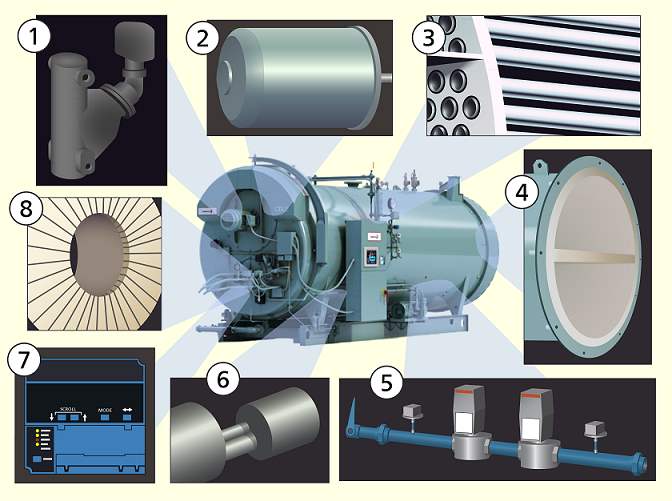

Figure shows the boiler system’s major components for a Cleaver-Brooks model CB-LE 200 series boilers with a CB-HAWK boiler management control system.
- ‘’‘LOW WATER CUTOFF’’’
- ‘’‘BLOWER MOTOR AND FAN’’’
- ‘’‘TUBES AND TUBE SHEET’’’
- ‘’‘REAR HEAD REFRACTORY’’’
- ‘’‘GAS TRAIN’’’
- ‘’‘BURNER HOUSING AND DIFFUSER’’’
- ‘’‘FLAME SAFEGUARD CONTROLS’’’
- ‘’‘THROAT AND LINER’’’
