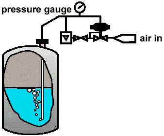

This simple Bubbler level measurement has a dip tube installed with the open end close to the bottom of the process vessel.
A flow of gas, usually air or nitrogen passes through the tube and the resultant air pressure in the tube corresponds to the hydraulic head of the liquid in the vessel..
The air pressure in the bubbler tube varies proportionally with the change in head pressure.

The system consists of a pipe, an air supply, a pressure transmitter and a differential pressure regulator. The regulator produces the constant gas flow required to prevent calibration changes.

Calibration is directly affected by changes in product density. It is frequently also necessary to periodically clean this device.
The tip of the pipe can collect material from the process, solidify, and plug the hole.
Bubblers are not suitable for use in non-vented vessels.
