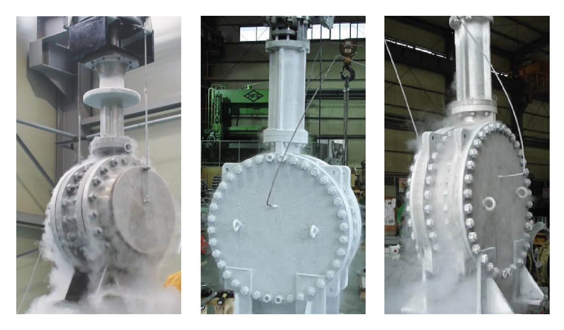

Butterfly valve in Cryogenic LNG Application
LNG Triple Eccentric Metal Seated Cryogenic butterfly valves are suitable for bi-directional flow and bubble tight shut-off at full rated pressure with extended bonnet according to BS 6364, Direct Mount ISO table, adjustable gland packing, one-piece blow-out proof stem, pinned disc and metal seat.
The materials used throughout are austenite stainless steel which maintains its strength at low temperatures. The sealing system is metal seated providing bi-directional bubble tight shut-off.
An extended bonnet design is used to create an insulation gas column between the stem packing and the cold fluid. This design prevents hardening and shrinking of the packing.
Butt-welding ends have a side entry maintenance system that allows replacement of the sealing ring without removing the valves from the pipeline.
