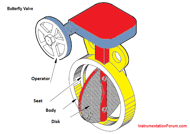

Butterfly Valve How It works
Butterfly valves are built on the principle of a pipe damper.These are also called butterfly damper valves.The flow control element in butterfly valve is a disk of approximately the same diameter as the inside diameter of the adjoining pipe, which rotates on either a vertical or horizontal axis.
When the disk lies parallel to the piping run, the valve is fully opened. When the disk of this rotary valve approaches the perpendicular position, the valve is closed. In butterfly valves intermediate positions can also be attained for throttling purposes.Intermediate position in butterfly valves are usually achieved by handle-locking devices.
Larger butterfly valves are actuated by hand wheels connected to the stem through gears that provide mechanical advantage at the expense of speed.Butterfly valves may be motor operated or motorized ,air operated or pneumatically actuated also.

Mechanical assembly of Disk ,Seat and Stem in Butterfly Valve
Butterfly valves stop the flow of fluid by the valve disk that rests on a seat that is on the inside diameter periphery of the valve body. Many butterfly valves have an elastomeric seat against which the disk seals. Other butterfly valves have a seal ring arrangement that uses a clamp-ring and backing-ring on a serrated edged rubber ring. This design prevents extrusion of the O-rings.Metal disk on metal seat (in metal seated butterfly valves) has failed to provide tight seal in butterfly valves.
The stem and disk for a butterfly valve are separate pieces. The disk is bored to receive the stem. Two methods are used to secure the disk to the stem so that the disk rotates as the stem is turned. In the first method, the disk is bored through and secured to the stem with bolts or pins. The alternate method involves boring the disk as before, then shaping the upper stem bore to fit a squared or hex-shaped stem. This method allows the disk to “float” and seek its center in the seat.
