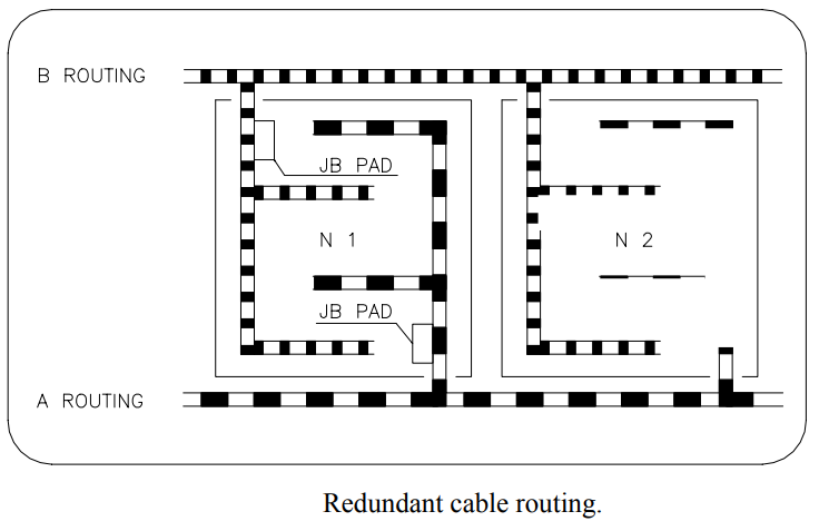

The cable ladders should not be filled so the height of the cable ladder side rail is exceeded.
Redundant cable systems shall be routed separately as shown on fig.1 room N1.
Field routing inside rooms in safe locations may be on same cable rack/ladder if this is not in
conflict with the redundant coverage of the area as shown on fig.1 room N2.
