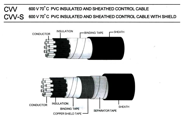

I’m doing job for japanse ,he mention cable specification for CV,CVS,CVVS,CVV,MVVS i need what is meaning for above all this and what is Standard for this please explain …

Control Cable and Screened Control Cable (CVV, CVV-S)

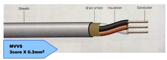

MVVS
The Data Transmission Cable with Screen Braiding

thanks for your response .now what i’m asking any meaning for cvv,cvvs waht about other two cables pls explain
