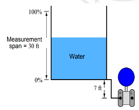

Calculate the LRV and URV for this ΔP-based liquid ___
Calculate the LRV and URV for this ΔP-based liquid level measurement system
Calculate LRV and UR
27-5 Liquid Level Measurement System
A. LRV = 0” H2O ; URV = 444” H2O
B. LRV = 84” H2O ; URV = 444” H2O
C. LRV = 7” H2O ; URV = 37” H2O
D. LRV = 444” H2O ; URV = 0” H2O
E. LRV = 0” H2O ; URV = 360” H2O
Answer: B
