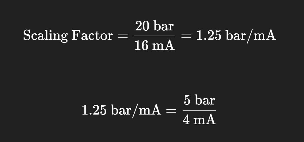

:two: Scaling Factor
:three: Convert Current → Pressure
Formula
Examples
Current (mA) Pressure (bar)
4 mA (4–4)×1.25 = 0 bar
8 mA (8–4)×1.25 = 5 bar
12 mA (12–4)×1.25 = 10 bar
16 mA (16–4)×1.25 = 15 bar
20 mA (20–4)×1.25 = 20 bar

:two: Determine the Scaling Factor
:three: Convert Pressure → Current
Formula
Examples
Pressure (bar) Current (mA)
0 bar 4 mA
5 bar 8 mA
10 bar 12 mA
15 bar 16 mA
20 bar 20 mA
